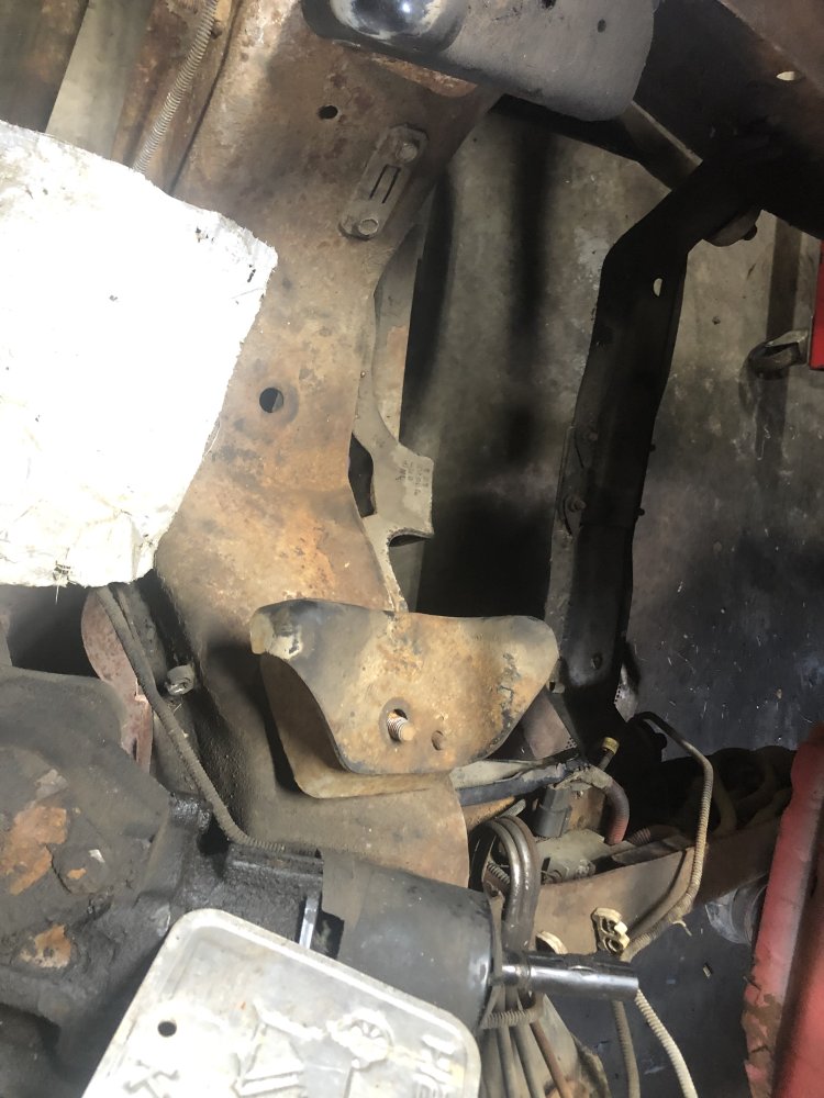

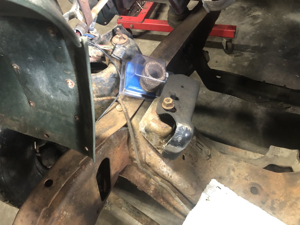

Leave them loose on the mounts and unbolt from the block . When it’s only the engine coming out I lift it up till it will clear and block the tranny up so you can bolt them back together and set them down . Then bolt the brackets back to the engine and tighten the mount stud . It helps if you have someone on top who can move the engine around to get the bolts started . Here’s a picture of my 4th and last one . It’s going 4.0 five speed . It’s a 90 BR 11 ! Good luck .
