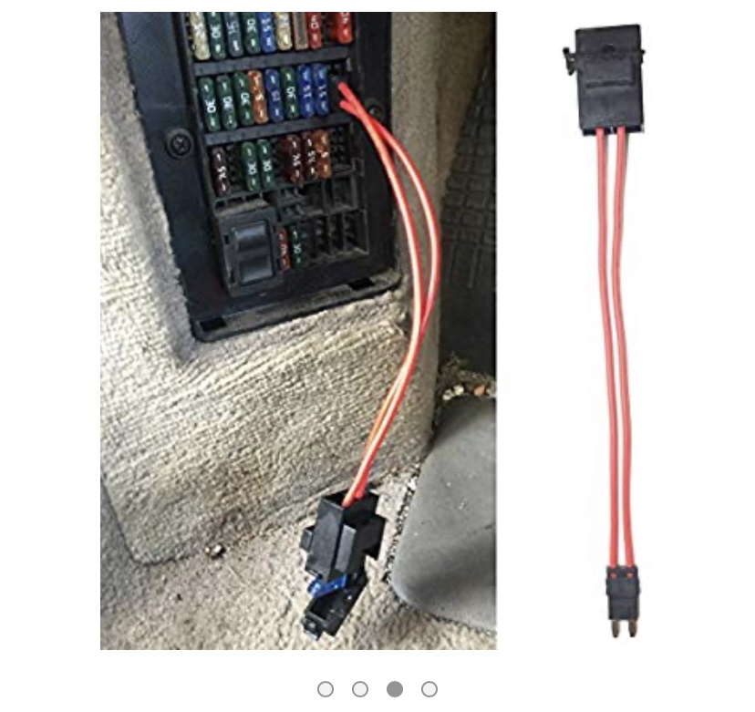

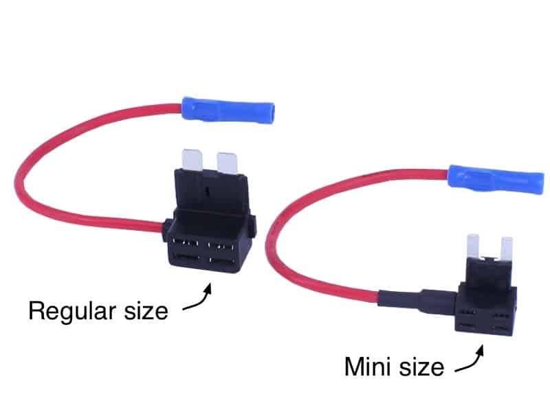

Without cutting a wire on your truck (so you can return it to stock if you ever find a replacement GEM.):
Buy one of these
35785
(First one I found in a quick search... you can probably find a better deal, faster shipping, etc)
Fuse adapter
Buy one of these:
35786
It called an Add-a-circuit. I don have a link to one.
Make sure you get them for the size fuses that your truck has. (ATM, I think.)
Get a 12 volt relay. Standard RY30, Bosch 4 or 5 pin, or equivalent.
Assemble everything...
Cut one of the wires on the fuse adapter in half. Attach one side to pin 30 on the relay. Attach the other side to pin 87. Plug it where fuse#26 is. Find a fuse that only has power with the key on, plug the add-a-circuit in there. Attach the wire from it to pin 85 on the relay. Ground pin 86.
If you do it this way, you don’t have to cut any wires on the truck.
Buy one of these
Fuse adapter
Buy one of these:
Many thanks for your very helpful reply. Your proposal is cheap, easy, and safe.
