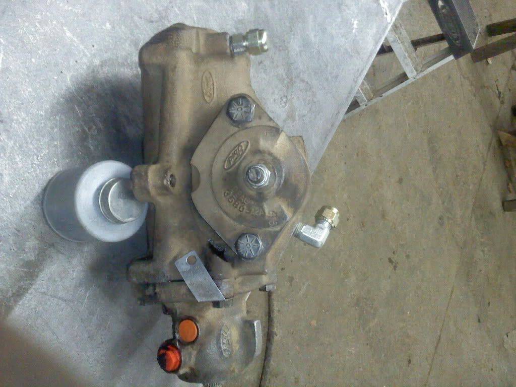

well i searched and didnt come up with many hydro assist ps box taps so i thought id post mine up i just compleated for my 84 bronco 2
I used steel 1/4" npt to jic fitings, pre drilled the holes with a 1/4" bit then steped up to a 7/16" bit and taped it with a 1/4"-18NPT tap.
I used a 90 degree fiting for my left turn port for better motor clearance
yep. stock box
ranger, bronco 2, f-150, 250, and 350 boxes are all the interchangable from 80'-96' the best i can tell.
