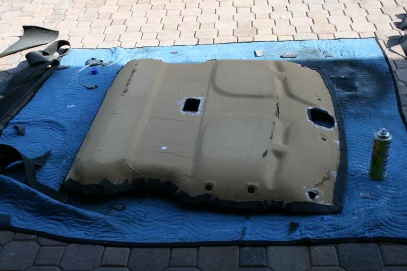

Now position the headliner somewhere that you will have room to work and where glue overspray won't be an issue. You will notice that I didn't remove my old headliner material. It was in good shape and not separating at all, if yours is separating or messed up you will need to fully remove all of it.

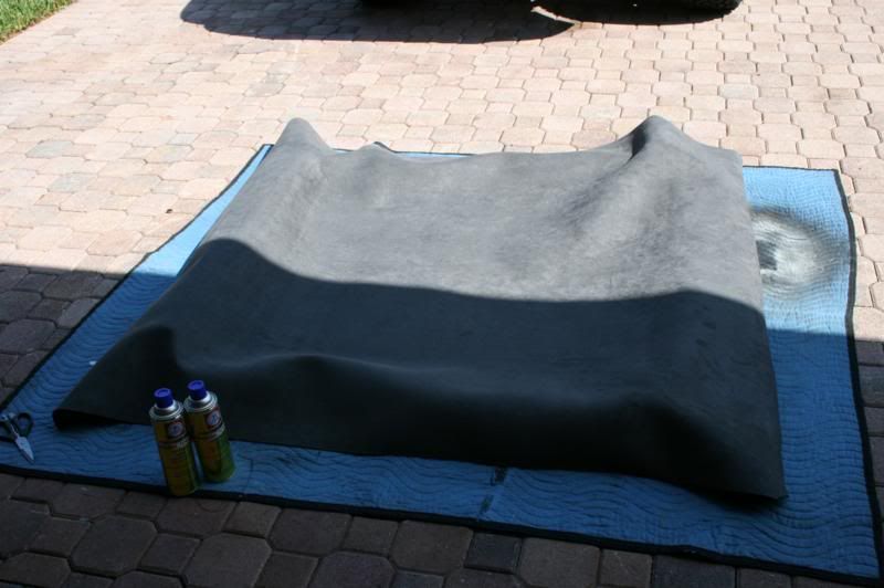

Next we need to lay the suede over the headliner to figure out how much is needed. Be sure to press the suede down so it is touching the headliner and then give yourself a good 6-8" around the edges.

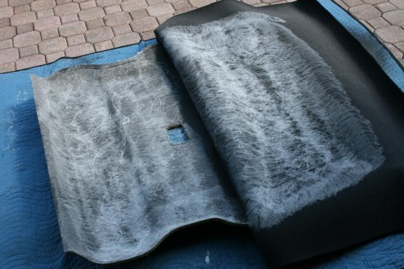

Now begin spraying the glue. You need to spray both halves and then let them setup for 2 minutes before you apply them to eachother. If you don't let it setup it will separate. The glue cans have an adjustable spray amount as well, I found this very cool and used the widest setting.

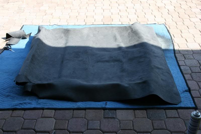

Press it down and then repeat on the other side. You want to work from the center out. If you get any wrinkles peel the suede up, pull and stretch it tight, then restick it. I had a couple and doing that made them go away.
Now carefully flip the headliner over. Then you want to trim the excess down to about 2-3" and glue it to the backside of the headliner. You will need to make some relief slits in the corners and other bended areas. Also cutout any openings, I used an Exacto knife to do it.

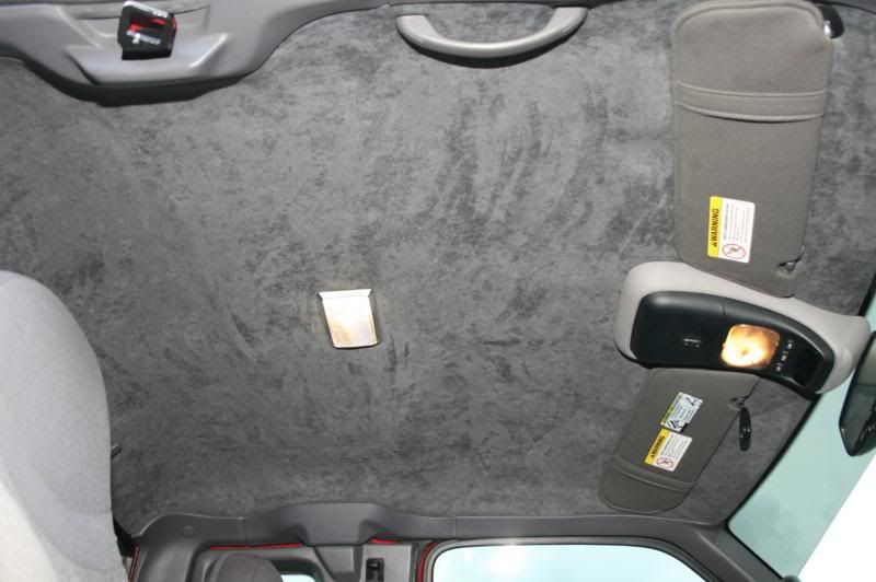

Headliner is complete! Now reinstall and enjoy. If you choose to change your headliners color I would recommend using SEM brand interior trim paint to make the grab handles and other items match.
