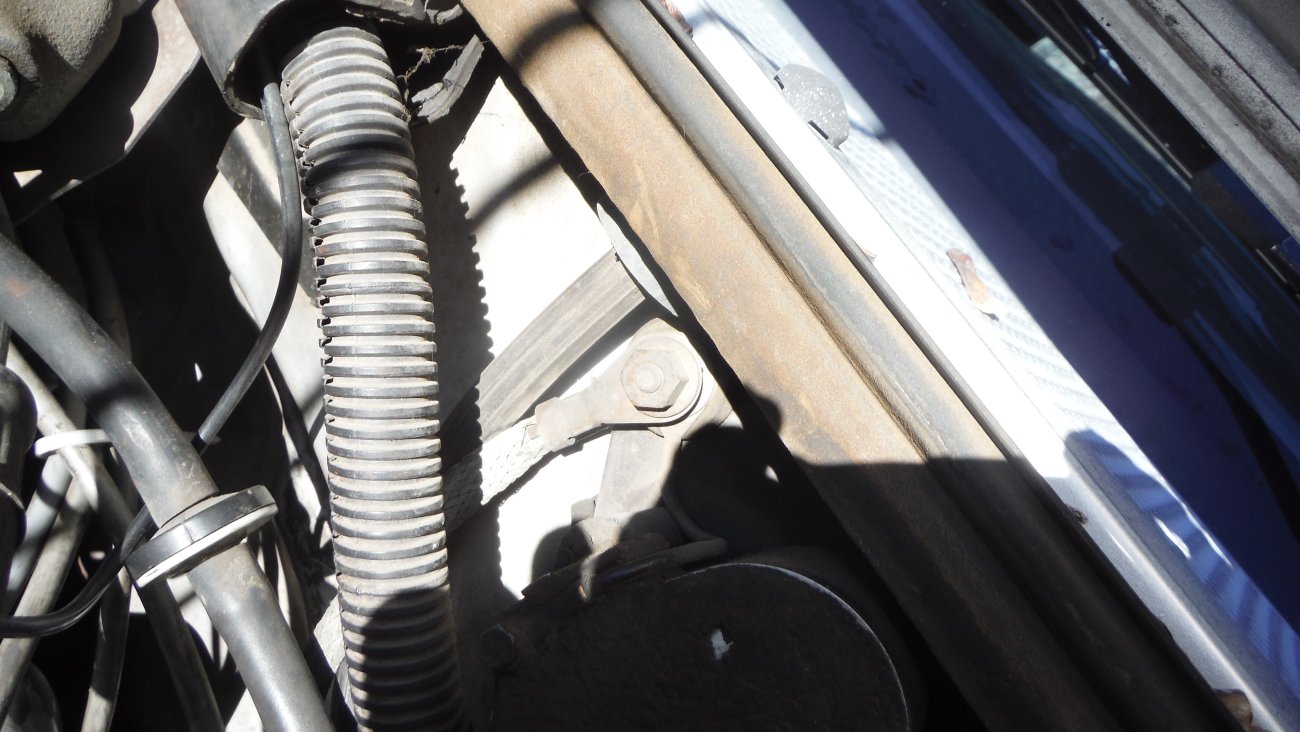

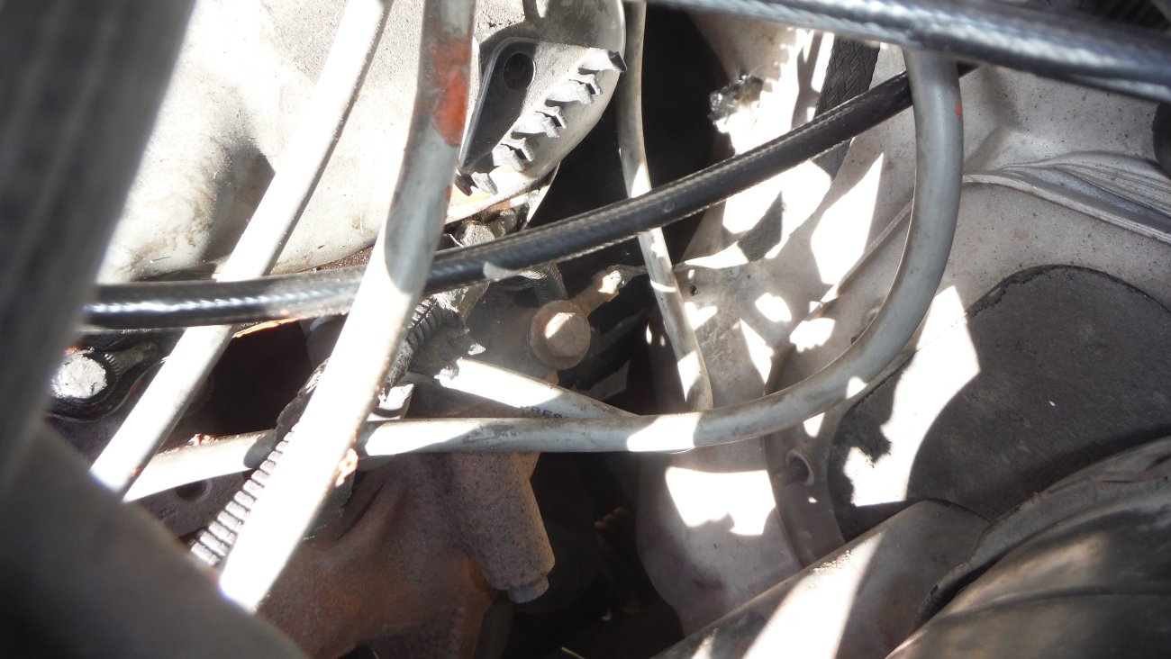

here is pic of the ground wire
here is pic of the ground wireView attachment 122723
Weird and not normal. That setup is completely dependent on the bolt providing the ground since the exhaust gasket would be an insulator preventing grounding through the manifold to the block. Certainly not ideal.
There should be a braided ground wire running from the firewall above the engine and fastened to something directly on the engine. I have that, and another wire that runs from the battery to one of the bolts that hold the starter in. I think there's a third running from the engine to the frame.
