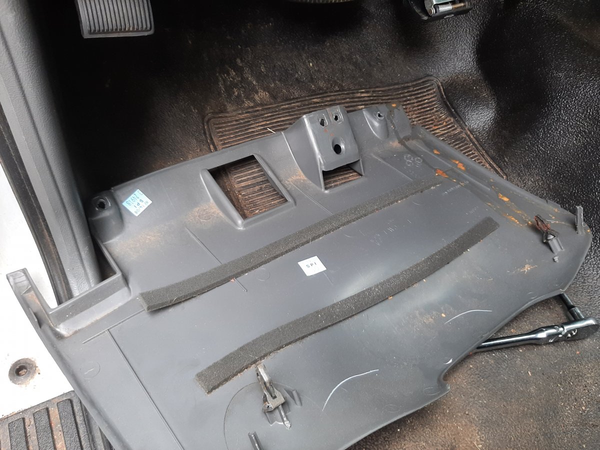

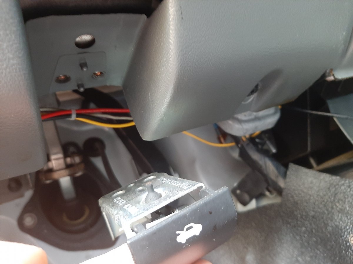

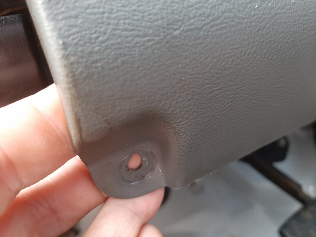

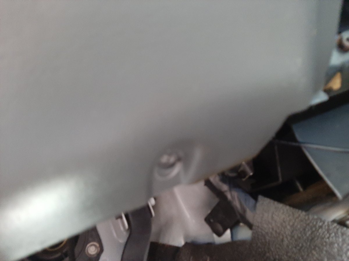

Ok two 7mm on the hood latch, that should drop. Then two 7mm on each bottom corner of the panel then that will pull out, then just pop the top clips. 4 screws and two clips.

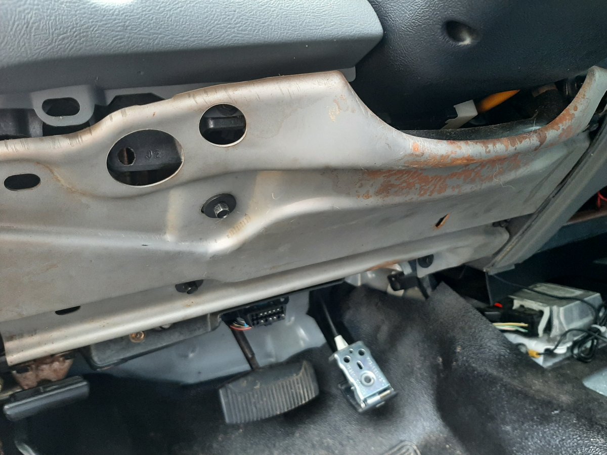

Second to last pic you can see all 4 screw holes on the bottom and the two clips for the top.
Taking the steel panel off is self explanatory Im not pulling that off lol.
