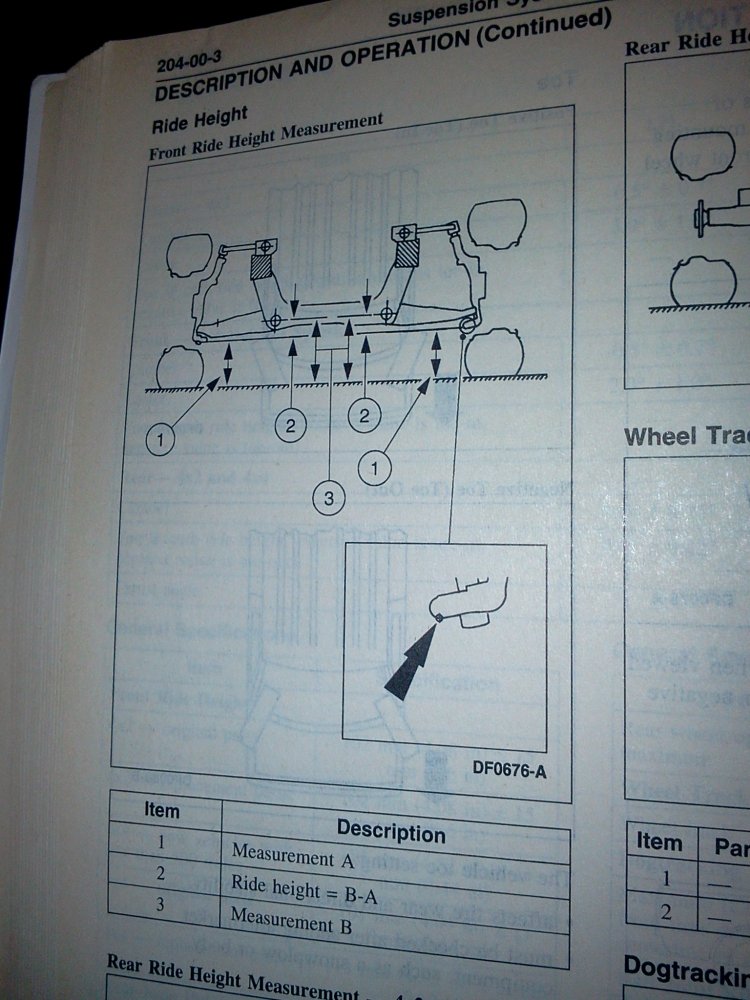

for a 2wd it's 102mm/ 4.08"
4wd, new parts 113mm/4.52"
4wd , original (I guess that means well broken in) 101mm/4.04"
I was thinking 1 would be 98-06, and the other the 07-11 when they lowered them an inch.
that's from a 2005 manual, so yes, 07+ is probably different specs.
anybody have a newer manual?
