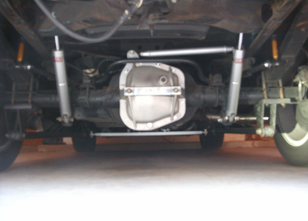

Older thread but I just ordered my PML cover. My 7.5 one that I have had for years is showing it's age. It's been painted red and is still rusting...lol
Figured I'd get a PML. I picked up this one:

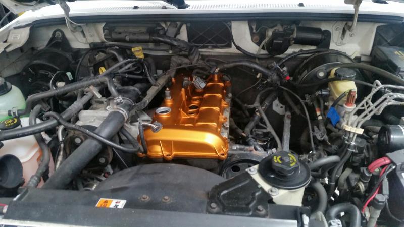

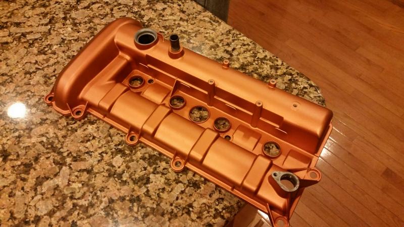

I am going to paint it burnt copper like I did my valve cover:

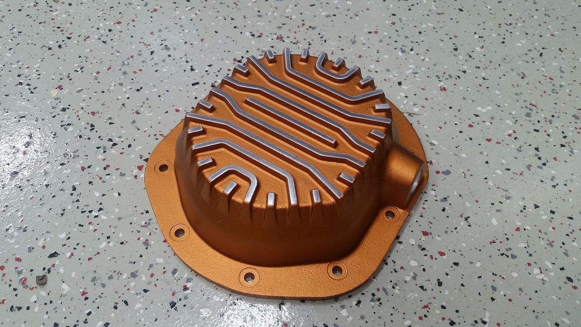

I'm going to tape off the fins and then spray it, and remove the tape so the fins are the aluminum color and the rest is burnt copper. Should look kinda neat. I like that this one has a drain plug at the bottom so no more removing the cover and resealing it...etc. Should go a lot faster.
-Nigel

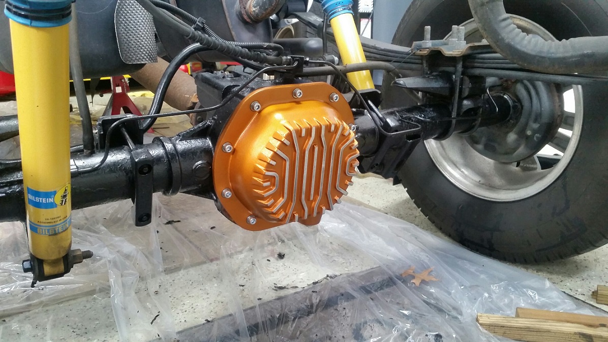

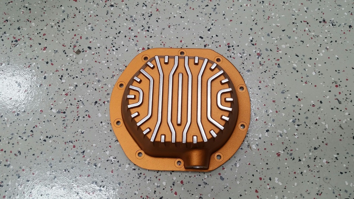

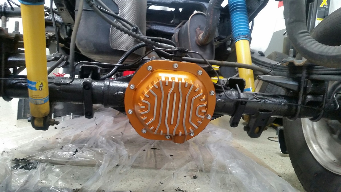

I should have bought this sooner!
Painted and sanded the fins, then clear coated.
-Nigel

Some threads deserve to be updated, NSGuy... BEAUTIFUL RESULTS!... <insert GREEN WITH ENVY smiley here> ... inspires me to get on with it. Did you actually tape all the fins, or just block sand afterwards? Sweet either way.
It's much easier to block sand after the paint cures and it comes out more even.

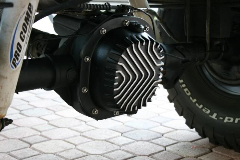

When I go to do the axle regear and install the torsen in the front and a locker in the back, I want to put an ARB cover on the rear axle. There isn’t enough clearance for anything more than the stock cover for the front.
OK NewShocker, you're now the 2nd poster on this thread with some kind of "furly industrial" black coating on your axle tubes... WTH is it???
I know, very sad, zero aftermarket for that issue... FoMoCo just shoe-horning everything 4WD in there as an afterthought...
Hello, is this thing ON?... anyone got a clue on what that black coating is on the axles shown in this thread?... anyone, anyone at all...?
The technical term for it is paint.
LOL... no, come on, that ain't just "paint", that's some kinda undercoating or furnace paint, tested on the surface of the Planet Mercury... youse guyz izz holdin' out on me... ;):unsure:
might be por-15. I just “bug-bomb” mine with rustoleom flat black every so often, frame rails too.
