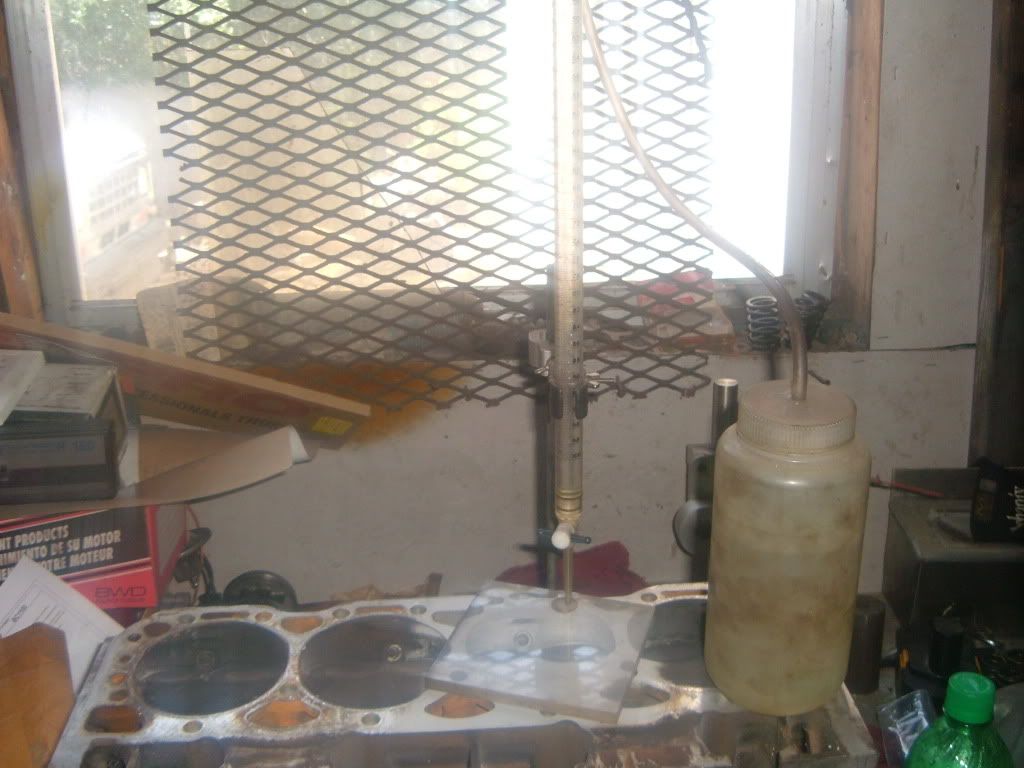

The first set up is used when the valves do not protrude above the gasket surface.
This is simple in procedure. Fill the CC burette with a fluid, I use water, some use a color alcohol, cover with the sealing plate, then flow the fluid through the hole in the seal plate till all air bubbles are out of the combustion chamber. Then read how much fluid has flowed from the burette.
This stock head measured 54cc
