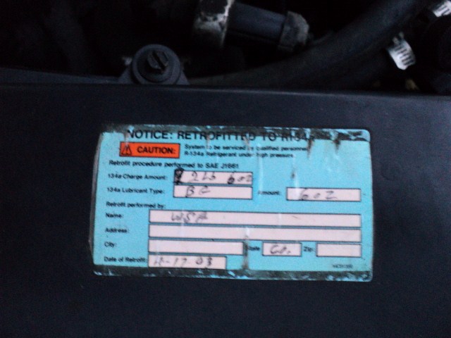

how much
My B2 came allready switched over and the sticker the A/C company put on it says 2lb 6oz. :D hope this helps.
If you used the cans from the store they are usually only 12 oz. not a full 16oz. so by the sticker on mine you would need 38 oz of 134A

Thanks xr that was exactly the answer I was looking for.
