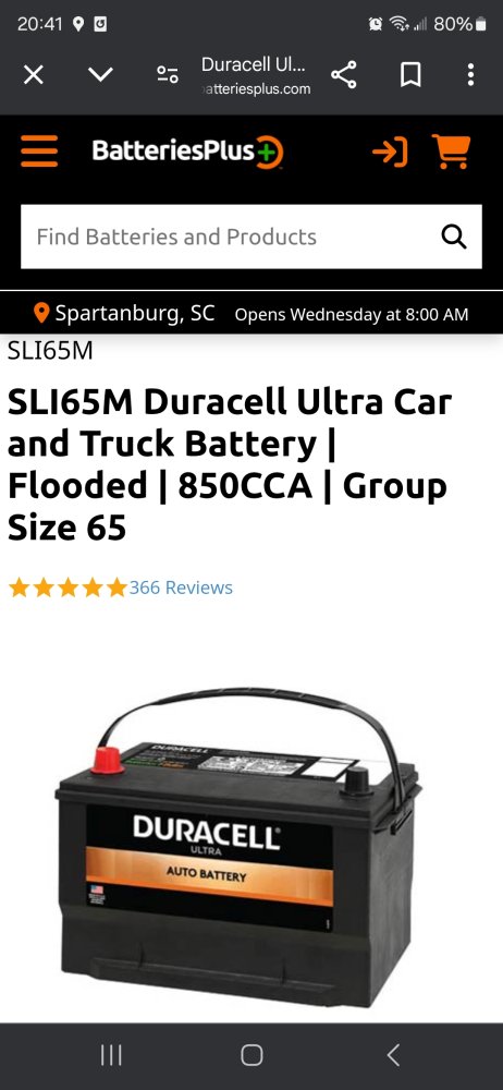

Right now, I have an 87 and 88 Lincoln Town Cars, both 5L/302, both with the slight dealer HP upgrades. If I put 1000 miles a year on either one I’ll be surprised. I don’t remember what the original battery size was, but since I got the Rangers I’ve used 65, and I think I upgraded one of the Town Cars to a 65. When I turn the key, they spin like a top. I also have a 7.5L/460 in my 78 Mark V which spins like a top off a 65. I think they’re all 700 or 750 CCA. 65 with 700 CCA should be everything you ever need to start that 5L you’ve got.
