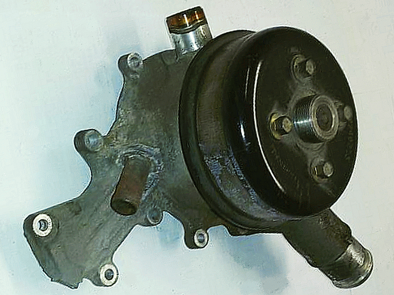

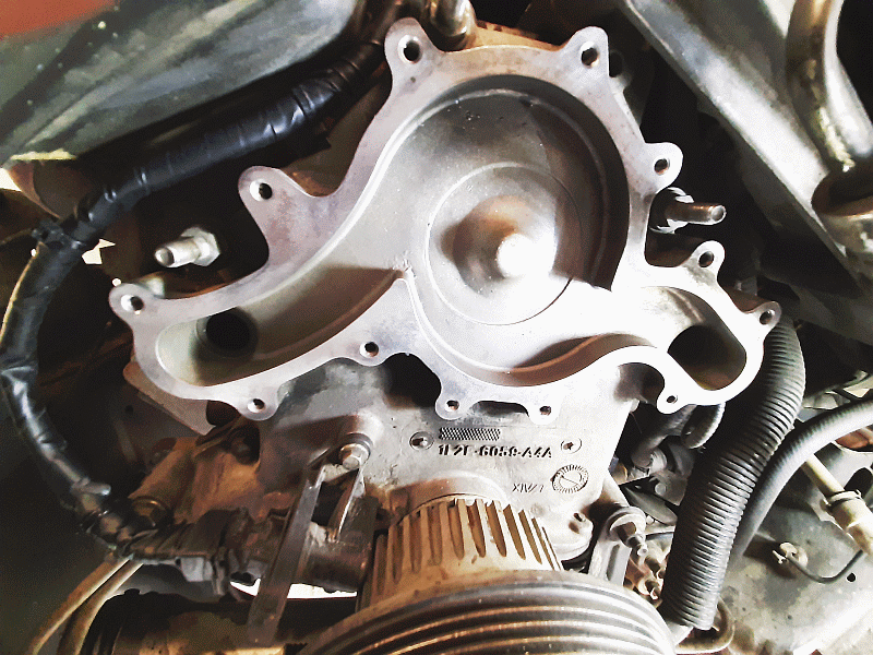

If replacing\removing the Shroud+Fan+FanClutch+SerpBelt+RadiatorHoses+ThermoStatHousing,
the WaterPump is connected to all the above items & easy to change, once above items are removed.
Considering 100kMiles+, I'd choose to swap in a new FoMoCo pump, then cleanup+lube+bag old pump as a spare;
at least you'll have some confidence in a new pump after running it a few hundred miles in hot summer weather.
My factory Pump went out at about 150kMiles, but new pumps\bearings can be bad from get-go; it's a JudgementCall\CrapShoot.
