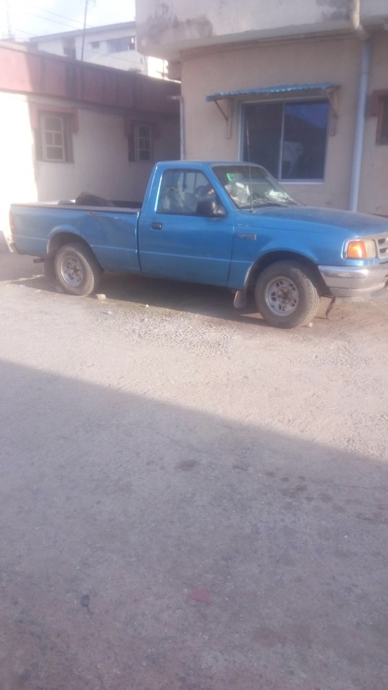

That's how my truck looks like.

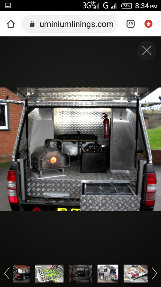

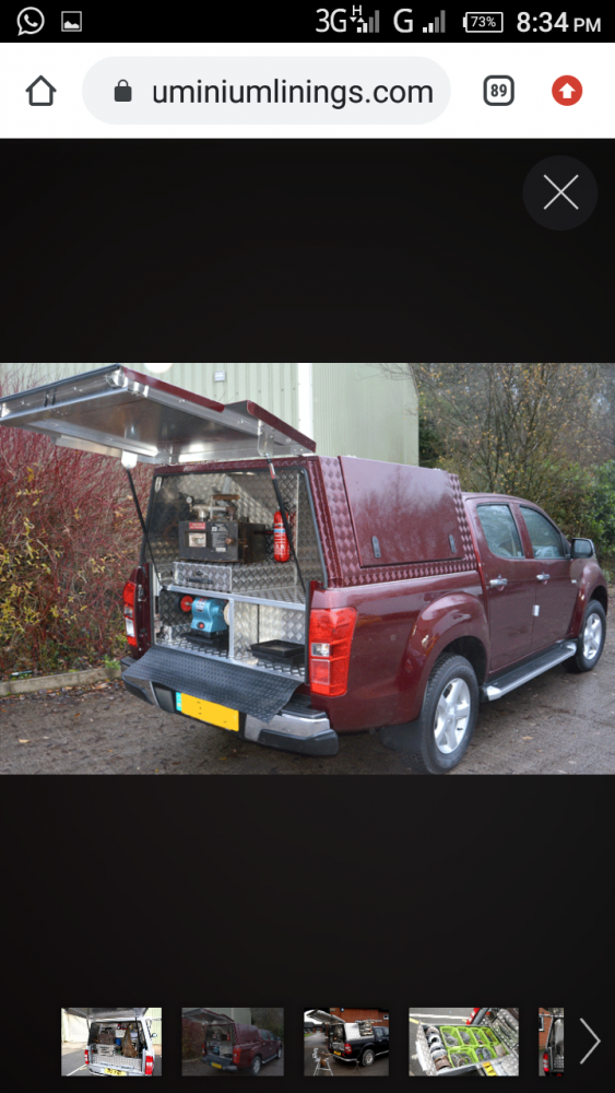

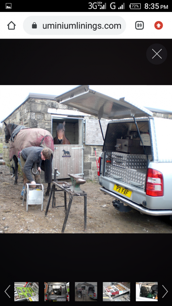

Here are some pictures I got online some months ago.

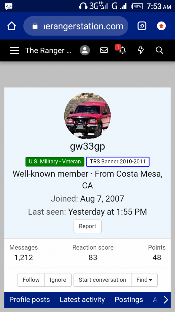

Take a look at this member's truck. Look closely at the box like cargo stuff covering the rear of the truck. That's what I'm trying to imply by a CARRYGO or so stuff.
Zoom on the image of the truck in his profile, you'd see it.

That looks like a good setup for a blacksmith. Is that the kind of work you do?
49197
The Picture is not of a ford ranger, BUT I've seen the same setup on rangers before.
I almost bought one with it, topper with boxes on both sides, french doors on the back (this one doesn't have), and morgue slab so you don't have to go crawling into back to get something.

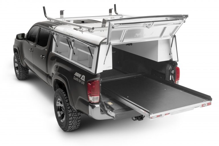

There is a great sliding truck drawer by Decked
Besides that, you can build your own using metal, wood, or both.
I prefer loadouts over campers because you can still use the bed for plywood and have a rack for long lengths of wood or metal, and carry a ladder. And most importantly, still carry bikes.
Also my biggest factors are ease of access, and also security. You may want to consider something heavy duty and locking, like a JOBOX. I use one when working in seedier areas. Just about everyone I know has had their tools stolen at least once in their life.
