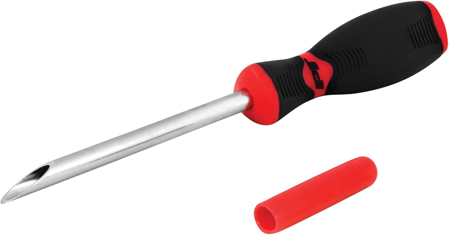

Get yourself one of these and use and existing grommet. It will make things so much easier as long as the wire is 10 gauge or smaller.
I have one of those too...
do you use it to sew up a big roast?
It creates a hole in the grommet for the wire to pass through and because of the way it pierces the rubber, the hole seals right up around it. Think of it as being a temporary conduit. Just remember to pull the tool off the wire before you crimp the connector or terminal on the end of the wire.
