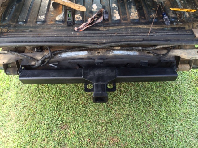

No guides that I know of but I got a junk yard one to install on mine and welded it in between the frame rails to get it up higher for clearance. I have done this on my last two trucks. I just cut the length of the 2x2 cross bar on the hitch so it fit tightly between the frame rails and welded it in place.
On the b2 I had to add plate on the bottom to get the strength needed and to get it attached to the frame well
Not a great pic doesn't really show the reinforcement but it's all i have.
