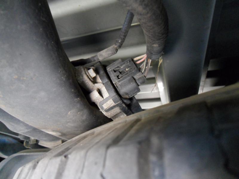

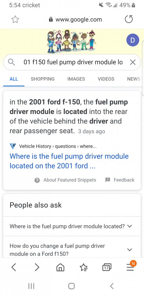

First i found this....

But then i found this...
Looks like its between 2 crossmembers dierctly across from one of the rear wheels. Pic description said 02....but i imagine should be the same
Congratulations. You found the FPDM.
Take it off and look at the big hole in the back of it.
Then do NOT buy the Dorman replacement that bolts right back on to the frame. Spend a few extra dollars to get the Ford one. It comes with stand-off bolts that will move it off the frame about a 1/2 inch so that it doesn't collect crap and rot out.

I found that pic....
On google.....
She said she was unable to locate it on her truck.
