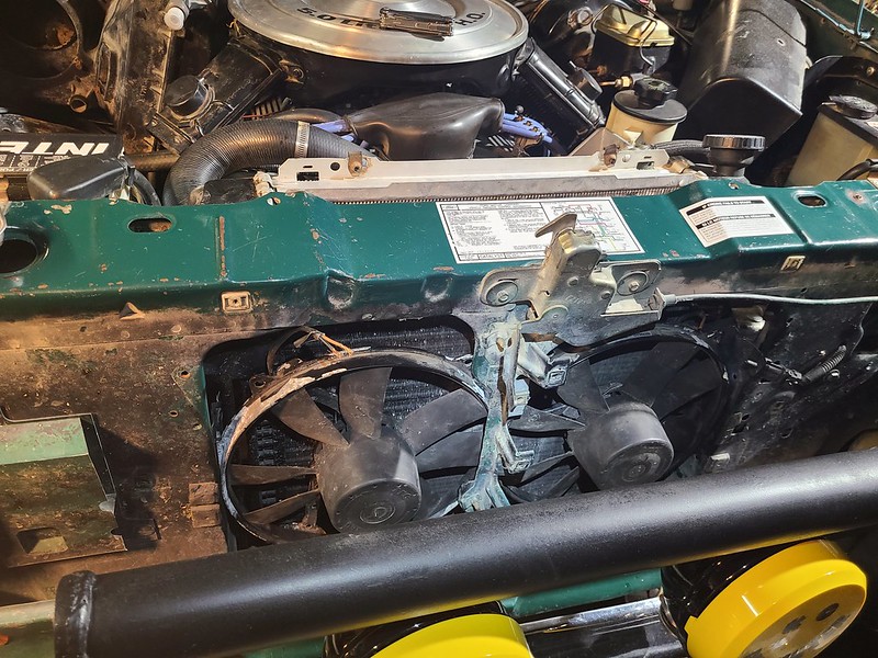

hey, i built this fan into a home made shroud on my build. the nice thing with this fan is that the motor is built into the shroud. saves room....
thread....
How much room you have depends on what front accessories and what radiator you have. I have the Duff/Northern radiator in mine and '86-91 Crown Victoria/Grand Marquis accessories... I hardly have room for electric fans and a mechanical one definitely doesn't fit. Explorer 5.0 front accessories open up a lot more possiblities. I had to run two fans (pusher/puller on both sides of the radiator) and had to cut out some of the grille to fit the outer fan.
