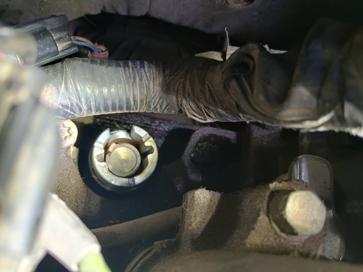

I am trying to replace the cam synchronizer in my 99 V6 Ranger. I took out the two 5.5mm screws and the 10mm screw and marked it and took pics.
The issue is that I can't remove the cam sync at all. I can't pull it out, turn it, or move it at all, so I'm unsure how to take it out???
*Any idea what I am doing wrong? Anything helps.

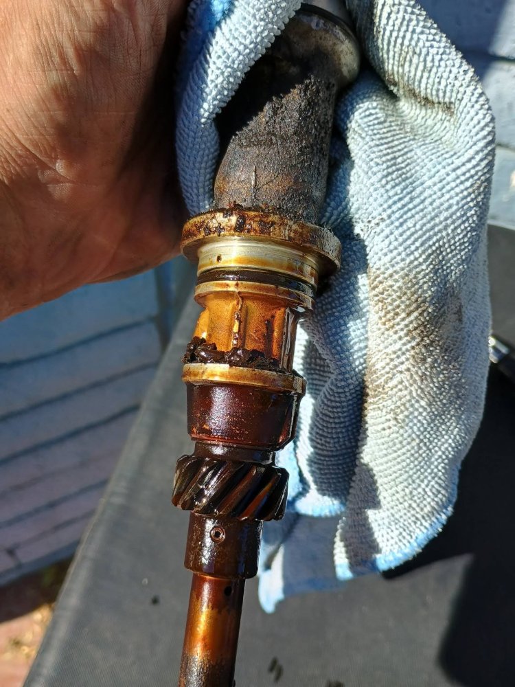

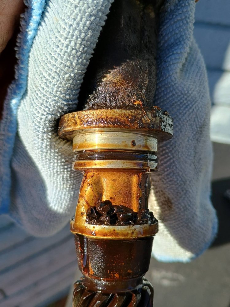

Update: I was finally able to remove the cam sync. When I got it out it had metal shavings in the sync like the images below. I am going to get a new sync.....
Did this cause any damage does anyone think? The black metal shavings are making me wonder what happened to the cam sync to do this?
Always learning new stuff on the Ranger. Thanks for any input or advice. I watched a video but am still a little afraid...to make sure I line it up right.

I don't think that came from the cam sync. If you look at the discoloration from the oil you can see the lower part is actually in the oil flow where as the top, just below the seal, is not. This makes me think it is rust more than anything. See if the chunks are steel/iron, use a magnet and this will help tell.
The gear on the other hand has a couple silver marks in it making me wonder why. This is where something has rubbing/wore a clean spot into it. Without being able to handle it it is difficult to tell from the pictures.

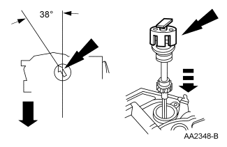

I used this chart when installing sync. I marked TDC with white out on the Balancer but am unsure how that times to the crank sensor wheel.
Anyway, I might need help with the codes p1309/p1409.........I am a DIY guy but make errors a lot....or miss small things.

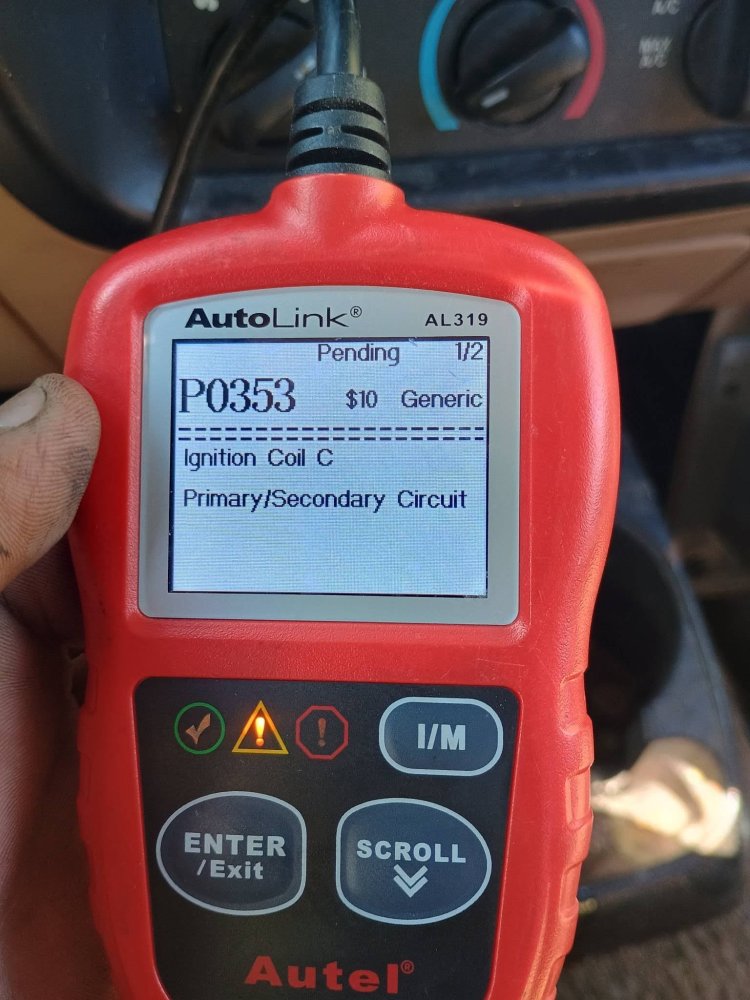

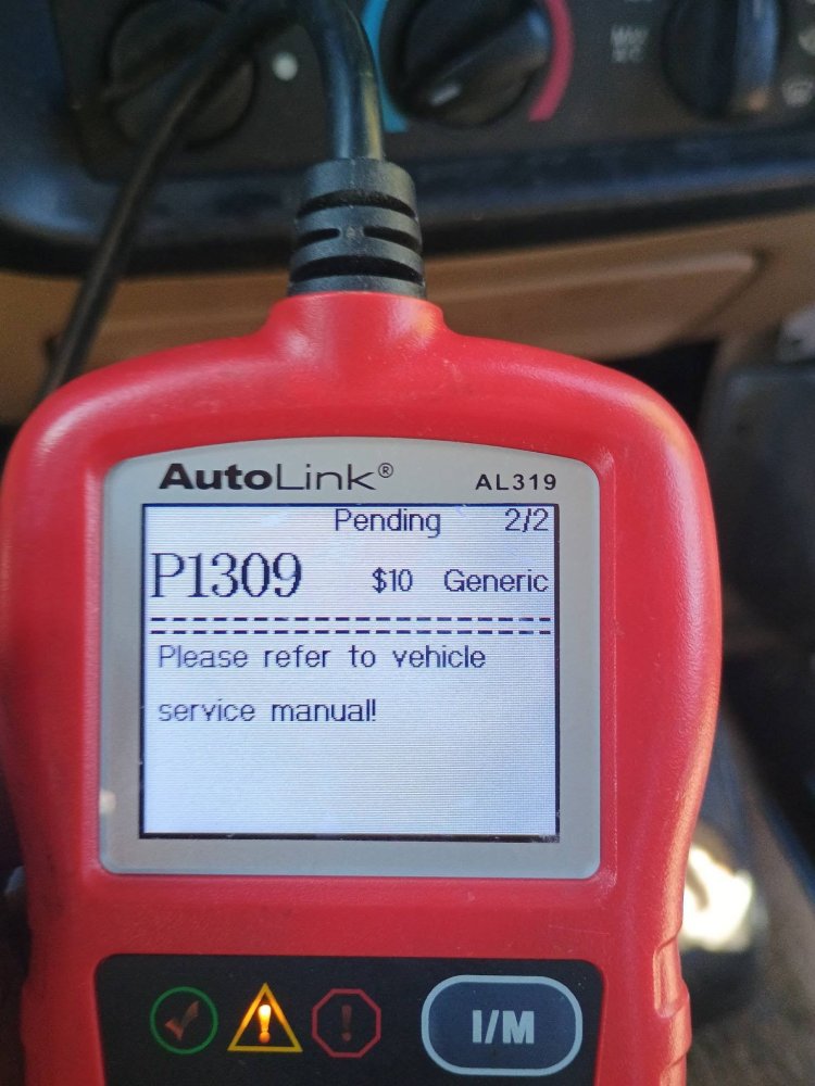

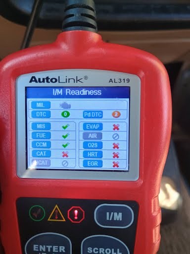

After a few miles driving the p1409 code is gone. These are the codes I am left with.
p1303 and p0353 and the attached IM Readings. The Cat-EGR-EVAP are always a Red X...here the O2 and the HRT are now Red X also.
Thanks for any input possible. I am hoping to get input of what I did wrong and how to fix it. I think maybe the timing of cam to crank sync? or cam TDC to crank WHheel? Still trying to put it all together.....my power animal is a turtle.....
