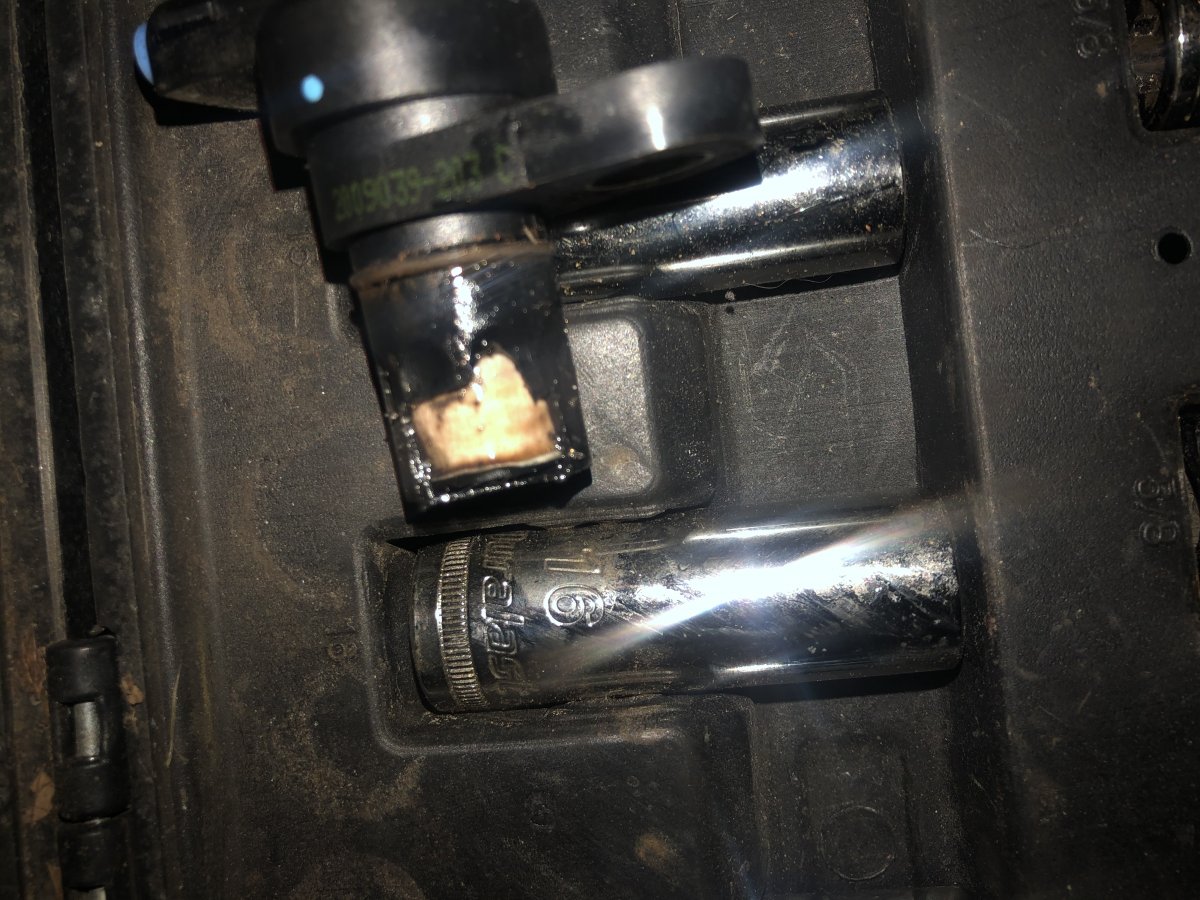

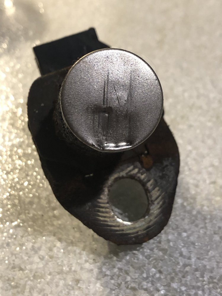

UPDATE: there are a few chunks of plastic in the oil that would approximately add up to the size of the chunk that broke off so I don’t think I’ll need to pull the axles today. The owner of the garage I was using needs my truck out today as “the smell is making her sick” so I have to just bite the bullet on this and just hope to god nothing breaks on the 2.5 mile journey back home
Gear oil does stink to high heaven and that is with my reduced sense of smell. I can't say I blame her. Just take it as easy as you can during the drive.

Yeah I understand that now. Also I just pulled both axles and everything looks fine so I cleaned it up and put it all back together. However there does seem to be some added resistance somewhere. Could that just be the gear oil being cold? Or do I have something else to worry about
Also... Thank you adsm08, Uncle Gump, and the rest of you that helped me out here. Honestly had absolutely no idea what I was doing or what was going on so thanks for helping me through everything. As of now the abs works as it should and I have a speedometer again. Just took a 25 mile test trip to make sure everything works fine and it’s flawless.
