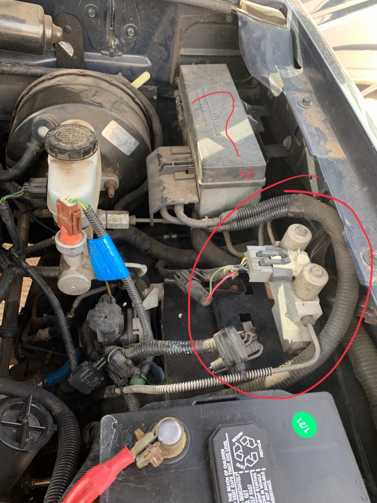

Hopefully someone can tell me why I have an ABS hydraulic unit on my 2000 Ranger XLT 3.0 flex (2WD)
*See attached - right side above the battery
Long story short...
I started chasing an occasional lockup at the right rear wheel and soon discovered I have what is referred to as an ABS Hydraulic Unit. Rockauto, as well as some others have these listed for years up to 1998 but nothing for a 2000.
Can someone help me understand why my 2000 Ranger has one of these?
Is it common for a 2000 to have one and could it just be an error that they aren’t listed for this
Or do I has some kind of oddball, leftover parts truck that rolled off the line that year?

All 2000 rangers had ABS. Rear wheel ABS was standard, 4 wheel ABS was optional. You have rear ABS. ABS units are complicated little buggers and very few aftermarket companies even bother to make them. You not finding a listing for one is most likely just because no one makes it anymore.
As for the lockup issue, could be improper adjustment, improperly assembled, leaking axle or wheel cylinder, bad ABS sensor, crappy replacement parts, rust forming on the drum... The list goes on.
