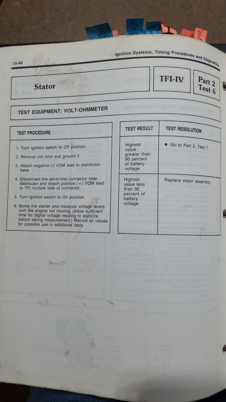

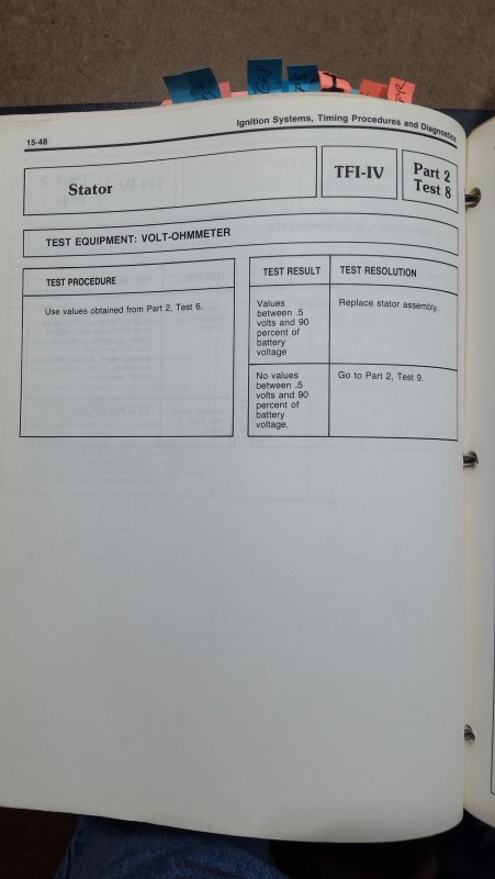

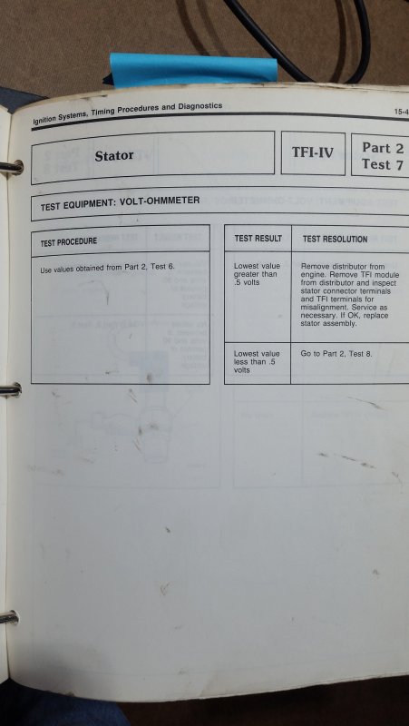

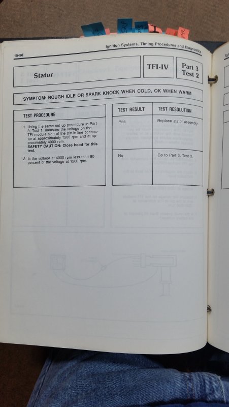

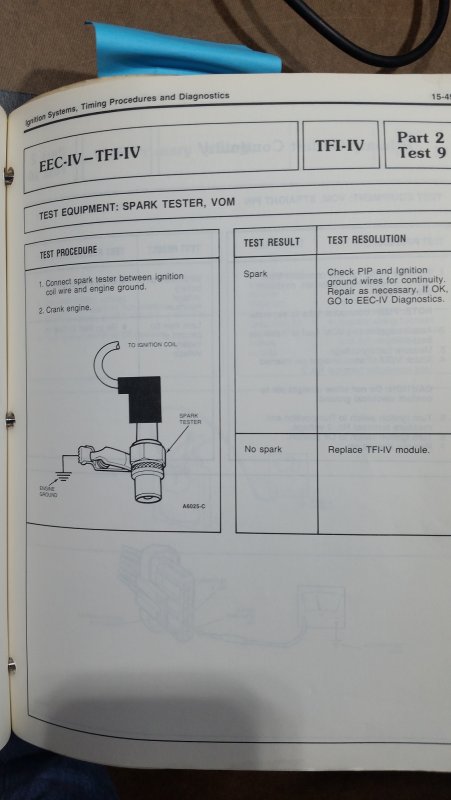

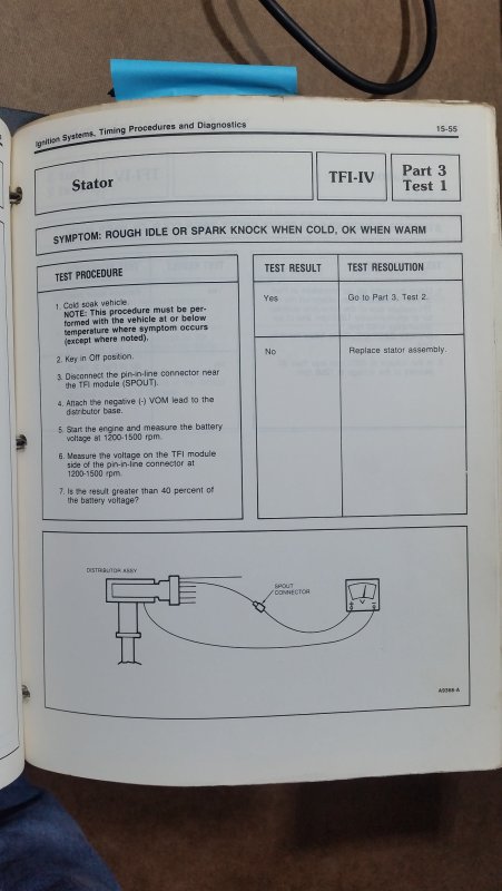

This is the best method I've found to determine if the PIP is faulty.
  • Like
Reactions: alp

I don't think there are specs for resistance testing the pickup coil. The Ford diagnostics flow charts describe testing with the distributor in the vehicle and checking voltage at certain steps.
I happen to have a couple spare distributors, one with a new pickup coil, and one with a used one. Using a cheap greenlee meter I got inconsistent resistance between two terminals on the new one, but nothing on the old one. Using a decent Fluke meter the readings were more consistent, and the old pickup coil then showed something. If you're going to test it, I would use Ford's technique. I think I got the important pages. They're from the 1987 Ford Engine/Emissions Diagnosis Shop Manual.
If you have the socket to remove/install the ignition module, I'd just put the old one back in to see if there's any difference in the way it runs. It only takes a couple minutes to swap them out.

Thanks for the pics of the manual, the PIP I was trying to see if it's dead for sure was the one in the old dizzy that got taken off the truck, but those instructions should still help for figuring out what the issue is with this new stuff. If this is going to end up coming down to tossing some parts at it, I may as well invest in a Picoscope to determine what actually is the cause of this.
