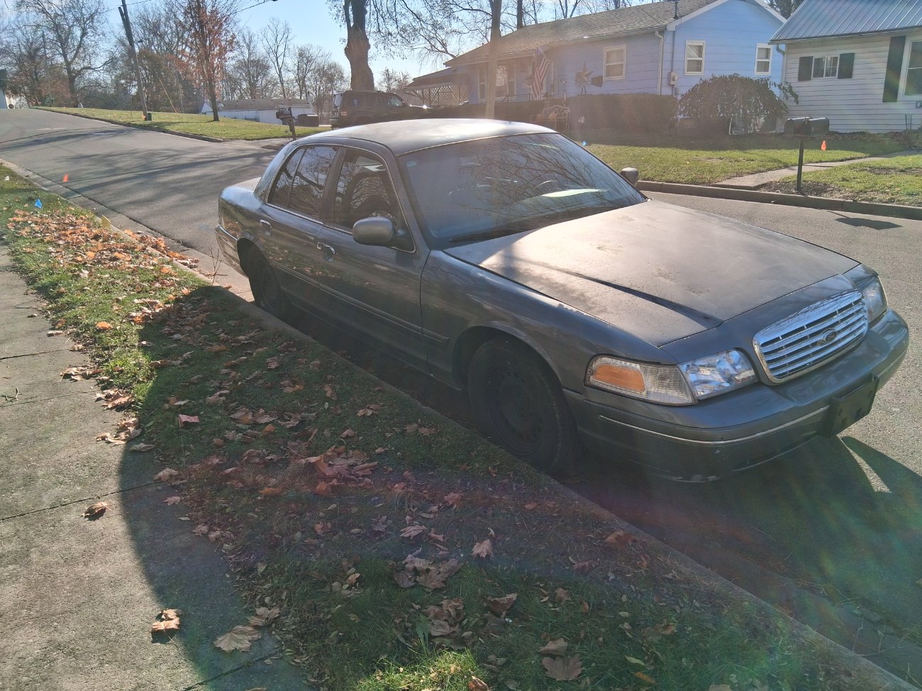

So...i just bought this thing to DD for 1100 bucks because my B2 is proving to be more project then DD...
Runs good, drives good, 225k miles...
