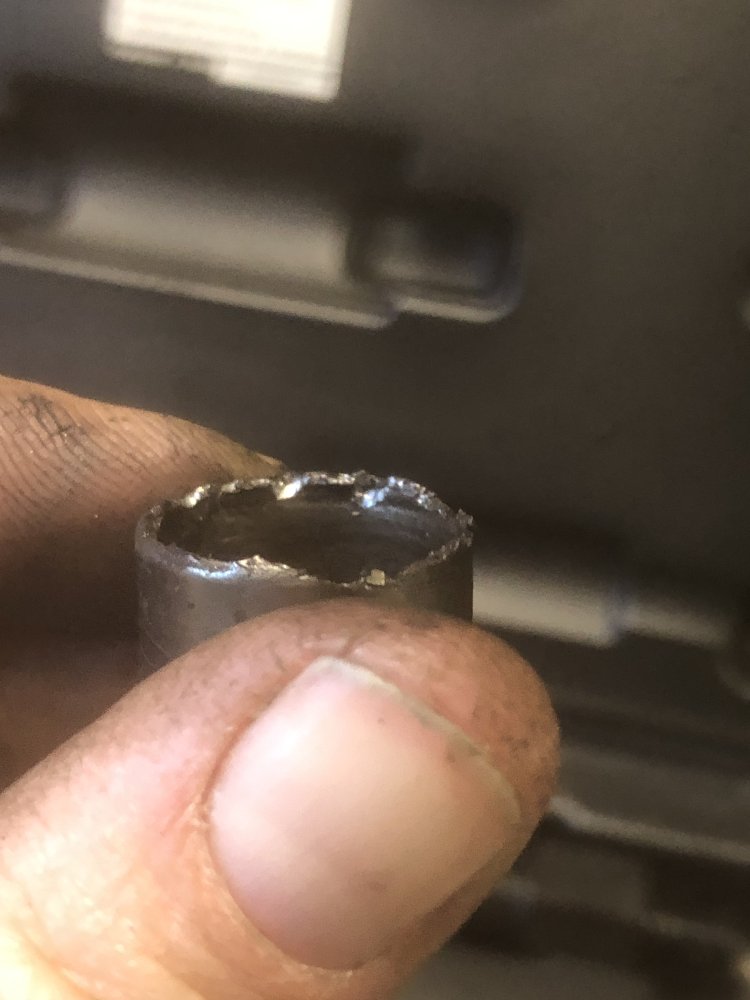

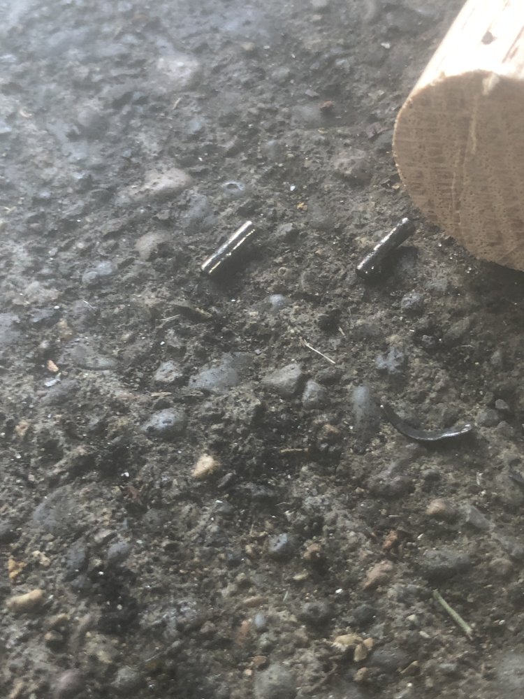

Well its definitely the pilot bushing. That thing is in a million pieces. Needle bearing bits everywhere. Wonder if I damaged it re-installing the trans after the slave cylinder replacement.

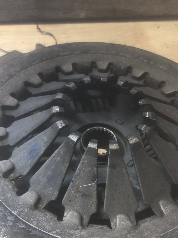

How does this clutch look?
Looks like its too worn. Going to replace the clutch and flywheel. Any info on flywheel bolts? Are they the same on the 3.0 and the 2.5?
