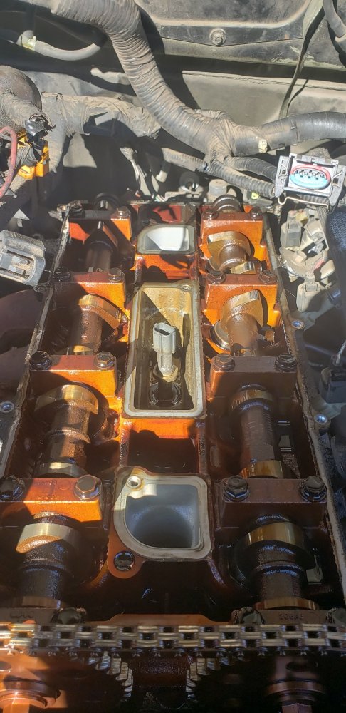

I am having identical problems with my 2003 DOHC 2.3l. I have found that I am burning oil through the engine. I have determined that there is an awful blow by that is being picked up thru pcv system and introducing aerosol oil into the incoming air from air filter. Compression test all showed within tolerance but the oil is coming from somewhere. Inside of my intake is coated in oil. I'm stuck. I'm losing 2 qts oil with a tank full of gas. I ran Royal Purple exclusively but can't afford the $12/qt anymore. I haven't been able to affect consumption at all. I bought the truck new in 03 and have loved the truck but can't trust it for long trips anymore. Ill be watching this one hoping for a solution.
The above picture is what I found under the valve cover gasket when I pulled it for the first time ay 175k miles.
The silvery tint is probably metallic shavings from internals getting destroyed
