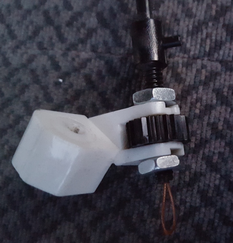

gear selector
Joe Dirte
Nov 21, 2015
5
1999
I figured this was the closest category to post about the gear selector issue. I picked up some plastic glue and glued the broken/cracked white piece and used two nuts on each side to reinforce it. It was either a 10-24 or 10-32 nut. I would recommend doing this even if your gear selector is fine to prevent it from breaking. It's only finger tight and didn't take long to fix.
