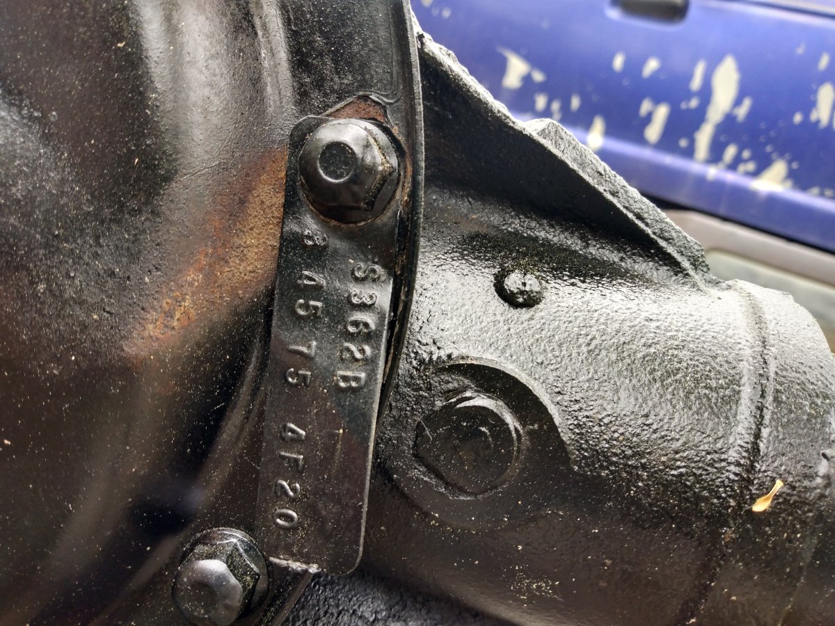

If you look what color or tooth count speedo gear you have now and get one less it'll probably be pretty close...

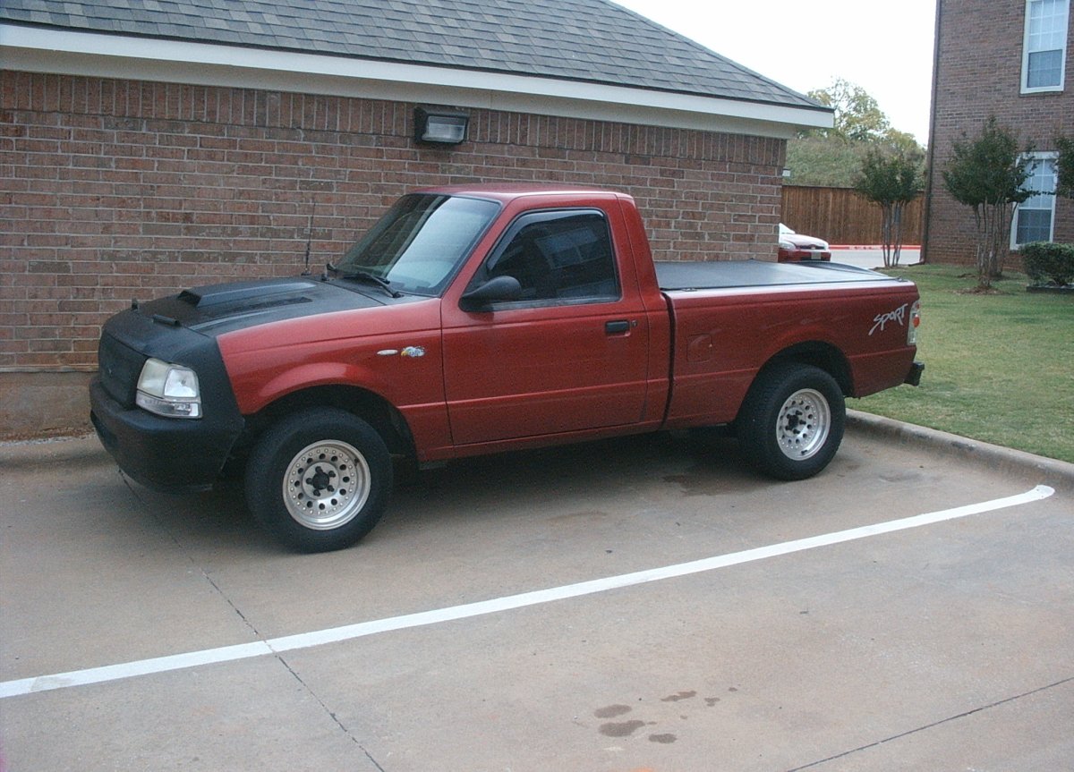

I changed my 98 from 3.73 to 4..10 a few years ago. I love it.
I didn't notice any speedometer or odometer reading change when I first did it. A few months ago, I put on shorter tires. 14's instead of 15's. Rear tires are now about a half inch shorter than the tires that were on it previously. 25.6 rather than 26 even. Speedo is off around 10% now. I pick up almost a tenth of a mile extra every mile. But, I don't care. It works for me. The old Cragar rims are worth it.
On a similar tack, my 04 Lightning has a tone ring on the axle. I was told by a guy on LightningRodder that it is used exclusively for the ABS system. When I changed the gear ration on it from 3.73 to 4.10, my speedo is now off 10%. Without touching the tires. I googled it, and it appears to be correct. Maybe Ron D. can straighten me out on this.
On Wednesday, I put a set of 17 inch rims on it. Race Stars. 17 x 11.5 rear, 17 x 4.5 front. Fronts are Mickey Thompson 28 x 6 x 17. Rears are M & H Race Master 390/40-17. They are about one inch taller than the old tires. So, will have to see what affect this has on it. when Mother Nature allows it. Maybe tomorrow.
