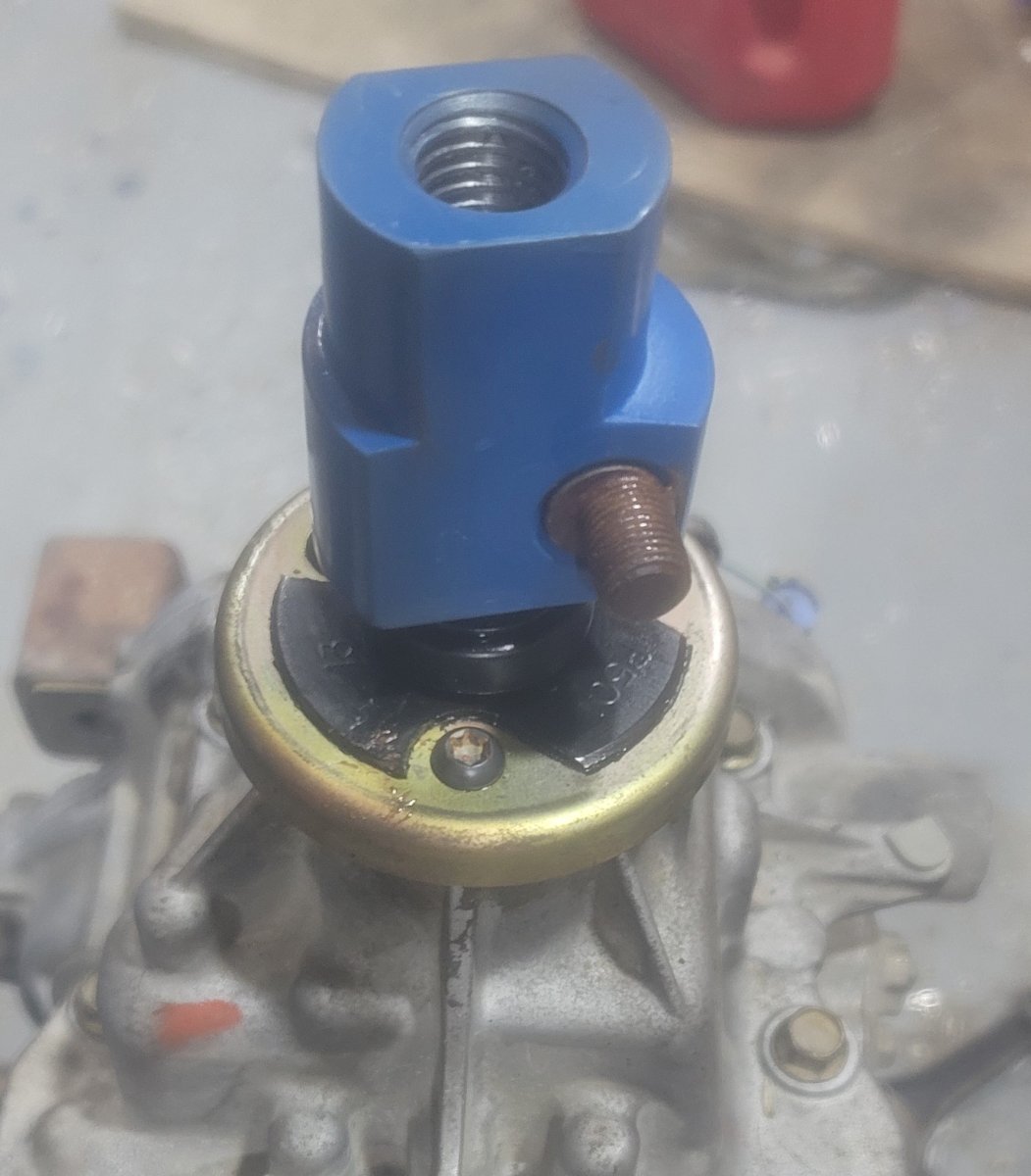

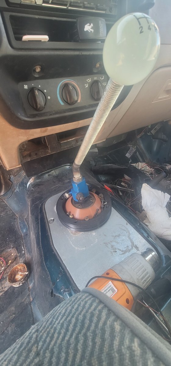

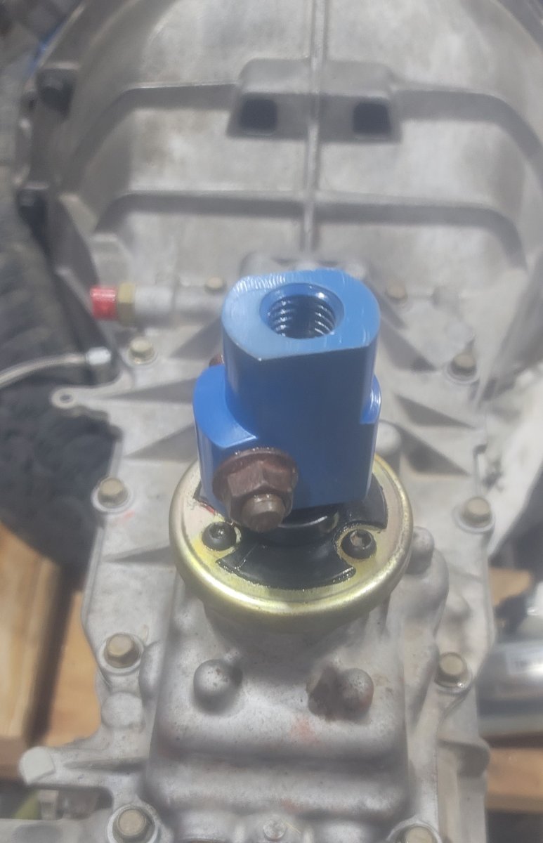

I machined this adapter from a piece of steel for my build, it uses the original cam bolt and nut. It should fit either an R1 or R2 trans.
I used 3/4" all thread that I bent an angle on for the arm. Something similar might work, then you could build the arm in whatever shape you wanted. Just a thought.

I like this. Might have to steal the idea!
I'd likely attempt to make it from a stock lever. Being the cheap bastard that I am. I'm currently using one made from conduit. It works.
I'm pretty cheap myself, made it from junk I had laying around. Here's a couple more pics for ideas.

Thanks. I guess it really only needs to be three holes drilled into a block of steel... Just have to get the bottom 2 just right so it'll lock on tightly.
That's the gist of it. I copied the stock one but omitted the key. It locks solid but will fit either trans.
