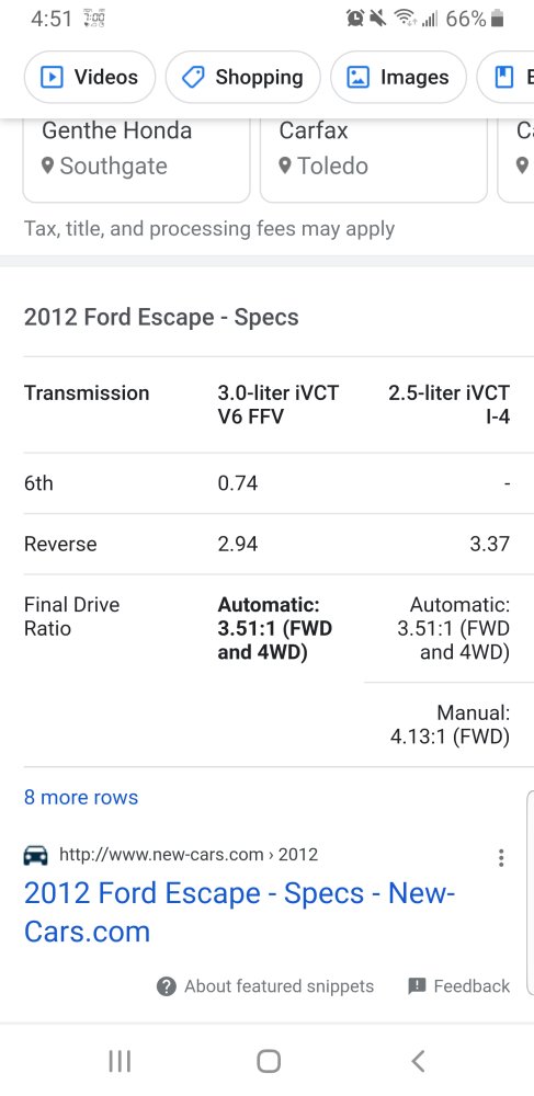

I doubt it, but is there any other gearsets for that escape rear? And are you sure its a 2.96? I think the Front Drive ones ran like a 3.4 to something.
Not sure what year your rear came from but according to google they ran a 3.51 across the board except in manual trans models
A 3.51 wouldnt be bad. Some of the 3.0 trucks ran around with 3.45's stock

its a 2011, the housing says 2.93 on it and everywhere i looked (dana web, escape forums) and they only talk about 2.93 for the AWD. it seems to be a dana 28 rear which barely comes up anywhere. I know the old rangers had dana 28 in the front and that's rarely seen and i don't think i can put front diff ring & pinion in rear diffs if i could even find them.
I tried looking again since you posted that picture and still didn't see anything, I found an ebay listing saying its 3.51 but the tag is all 2.93 LOL. I was looking forward to a cheaper/easier IRS swap as opposed to getting something from a cobra or the +15 mustangs.
