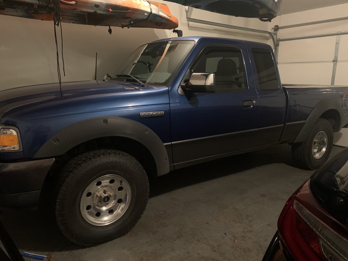

sorry for the crappy pic and delayed response but work has been insanely busy. I’ll start with shocks. The truck is leveled but stock so I’m assuming the. T-bar crank from what I have read. Does anyone have the Bilstein 5100 model number I need for this? I know I want 5100’s but not sure of correct length given the truck sits level and would like to keep it that way.

Even with a twist on the torsion bars to level the truck the front suspension travel remains the same. Just buy the factory length shocks.
