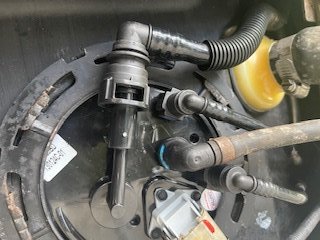

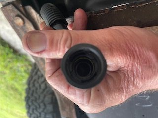

Hi all, while changing the fuel pump on 2008 Ranger XL Xtra cab 4x4 4.0l, of course one of the clips broke. It is the yellow one on 90 elbow that is the larger diamater fitting on top of the fuel pump that goes to the Evap system. All I did was touch it and it disentergrated:unsure:
Does anyone know how to get the clip, or elbow. Dorman makes a kit, but I am not sure it comes with the size I need.I tried a clip assortment from Amazon but no luck. The pink clips it came with seem to be similar but too thin and the break when yoiu put them in the fitting. Any help will be greatly appreciated. I need to get this truck running before the rotors rust!
Hope this works! Here is what it looks like.

Thanks for your reply. I just don't know what spesific size and type of clip to ask for or how to order it. I would get the Dorman kit if I was sure it had the right size with the right clip so it will hold tight. I have seen some vids where they substitute a chalk gun and flare tool in place of the doorman tool. Seems to work pretty good. I am hoping not to spend days driving to every parts store and combing throug the HELP! rack. If that's what it takes, that's what I'll do. Zip tie idea sounds promising.
The caulk gun and flare clamp does work.
I bought the kit and there are many fittings in there. Most I'll likely never use. But until you can say what you need... its all a crap shoot.
That is what is so frustrating. I have no idea how to find out what it actually is. Been looking at Ford schemactics online, can't find any description, part name or number or dimentions. Many of the fittings look similar, but the clip doesn't look the same. I would buy the Dorman kit, it has 1 that look like it may fit, but the clip looks different. It's def a crapshoot until I know what it is called or a way to ask for it by numerical specs etc.

This was the fix. Will post. Thanks!

Thanks to all who replied. The fix was a zip tie. Here is the pic.
