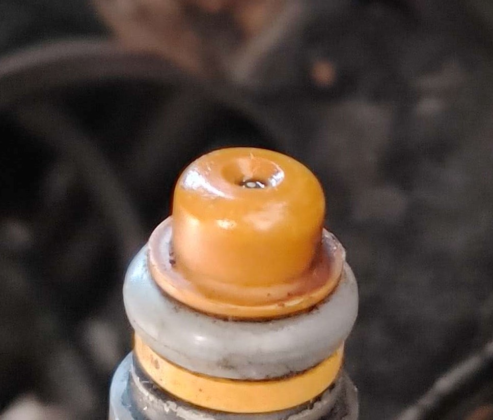

The injectors on my 1986 Ranger 2.9 are definitely leaking, but it seems like barely leaking. When I jump the fuel pump with the injectors not even plugged into the wiring harness, I can see a tiny bit of fuel coming out of the nozzle and everything gets a bit coated in gas and shiny. Not sure if this amount is normal, but it doesn't seem like enough to cause my truck to flood itself after maybe 3 tries cranking it and also getting 8.5ish mpg (when it didn't run so bad it could actually drive). The rich running also got worse over time, starting from 11-14MPG and starting good + running rough, to 7-10MPG and starting rough + running rough, to struggling to start at all. My fuel pump seemed to be making some weird noises too. The sounds are closer towards the front end.
I attached a picture of an injector after wiping it dry then turning on the fuel pump for maybe 6 seconds
Do you think these injectors are just old and bad or is that normal to see a small amount of gas? It seems like all of the injectors are doing this, but some seem worse than others.

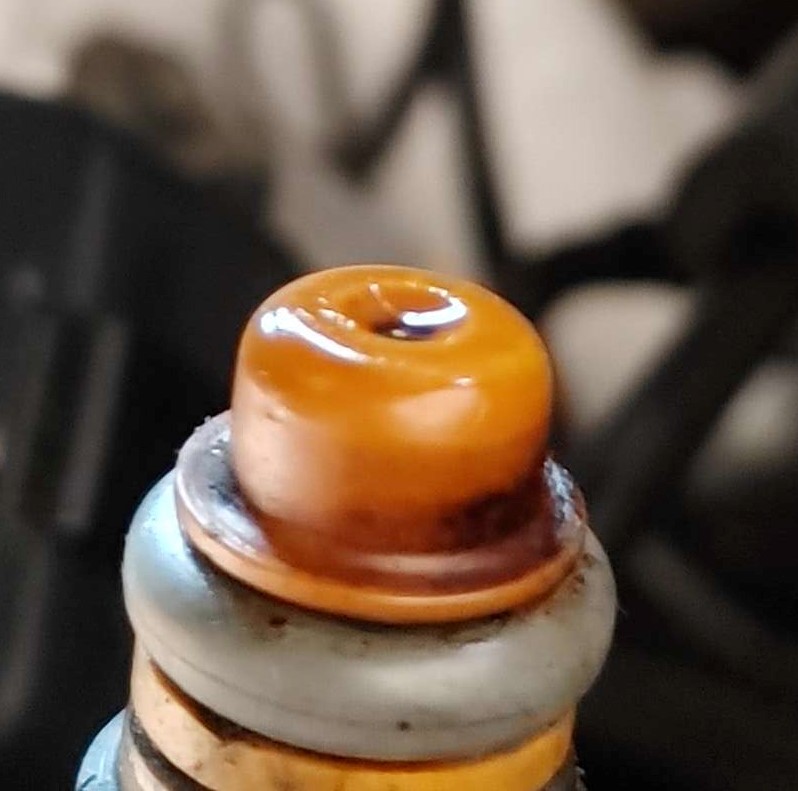

Just went out and tested them. Also, when I went out there I noticed a couple fuel injectors completely filled the little divot from where the needle is to the top of the orange cover thing while some dried out completely. The injectors are upside down right now too. See pic for what I mean.
Cyl 1: 15.9 ohms
Cyl 2: 15.9 ohms
Cyl 3: 15.8 ohms
Cyl 4: 15.9 ohms
Cyl 5: 15.8 ohms
Cyl 6: 15.7 ohms
No idea what they should be but they all seem very similar.
