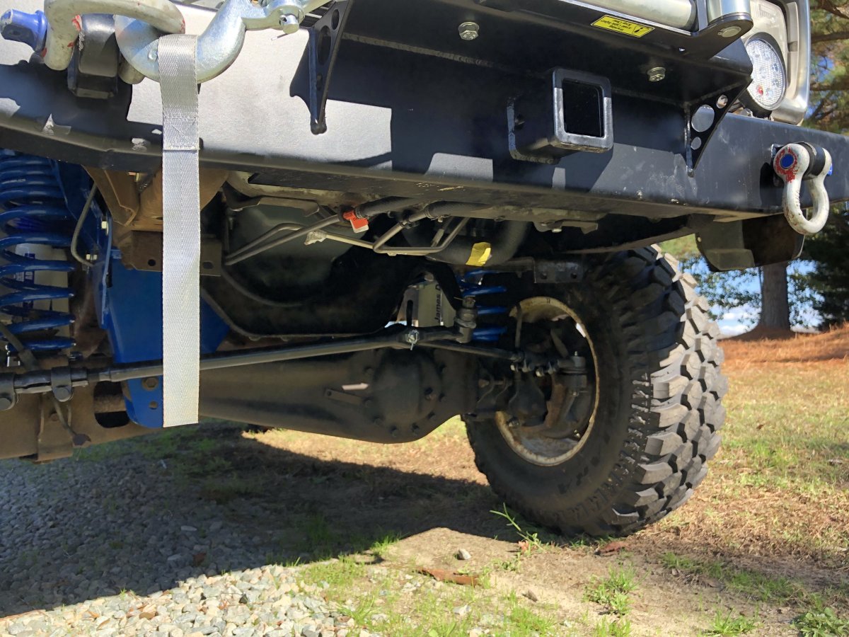

I don't have a good picture of my truck... but AOR uses a bracket that bolts to the frame where the skid plate attaches at the rear and bolts to the bumper in the front. Different bumper then yours... but it might be some fuel for thought.

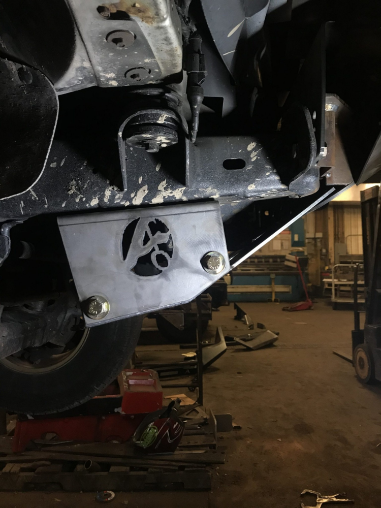

I built one from steel diamond plate just to protect the bottom of the Explorer radiator I installed.

Why is everyone so obsessed with front skid plates anymore? I don't have the stock crossmember that protects the steering and besides the steering the only thing vulnerable is the lower radiator hose that I have zip tied to the bottom of the radiator (converted from 4 cylinder to 6 cylinder radiator which involves flopping sides...). Looks like you have some trans cooler lines which makes sense on protecting... I'm sure I'll add something on my Explorer build but there's nothing off the shelf that will work. From the looks of it I'd just go from the front of the frame rails to the sway bar brackets at about that angle (maybe a piece of angle iron between the brackets for some structure), other than for weight purposes holes shouldn't be necessary, 1/8" plate or diamond plate should be just fine.
That's exactly my thoughts. Got a cover from an old engine core 1/8". Going to use the sway bar brackets since the Duff lift doesn't incorporate reusing the sway bar. And yes you are correct, the only reason I feel like I need one is the trans cooler lines... As soon as I installed them I was like huh... What a terrible location. But their routed per factory so I just want something to protect them from getting snagged.
