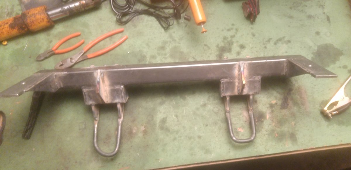

I have experience in this! Please forgive the awful camera.
I used 2" square tube, 1/2" round stock and I think 3/8" bar stock. This was my first welding project and was more for welding practice and learning about how metal behaves. I am happy with boxing in the frame with the square tube and the triangular bar stock braces. The next hooks will require thicker round stock because I was able to bend them pulling someone else. I do not believe it is necessary to double up the square tube to drop the hooks. It clears the spoiler just fine if you make them long enough. This cost $30 in steel and used existing holes in the frame.
