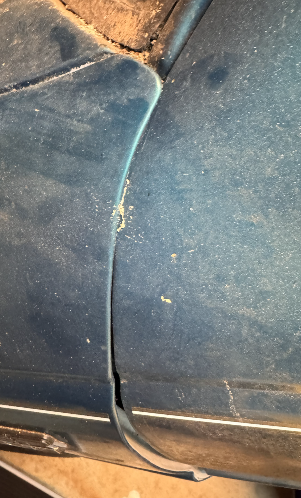

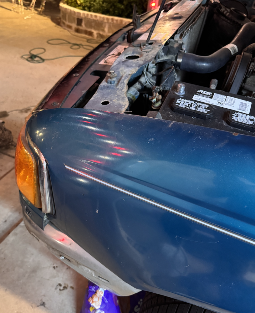

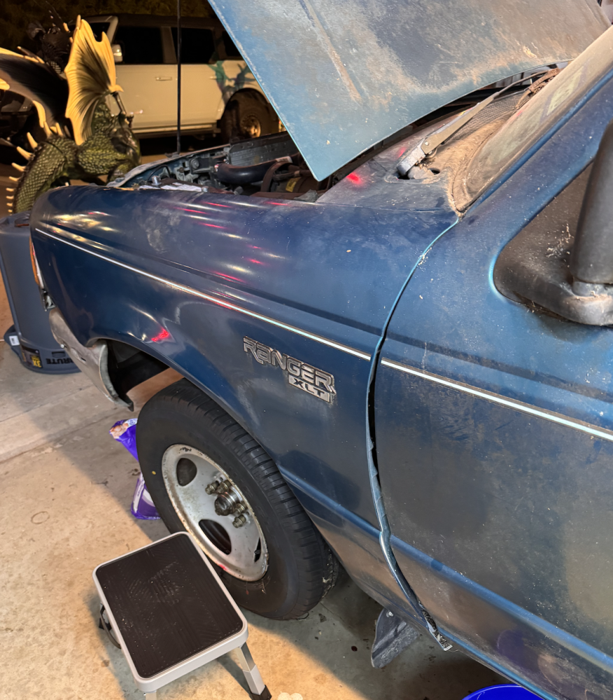

@scotts90ranger I took some pics of the fender, you can see that it's not sitting on there right, but that don't mean the frame is bent, right?
View attachment 120342View attachment 120343View attachment 120344
If I had to guess the front drivers side corner of the bumper pushed up on the fender and pushed the top back toward the door. If it were me I would loosen the fender bolts along the edge of the hood and stick something in the door gap to pry the top of the fender forward to fix the gap then tighten the bolts back down... The core support stuff that goes back to the cab is probably out of wack but no, that stuff doesn't mean the frame is bent, just the body...
