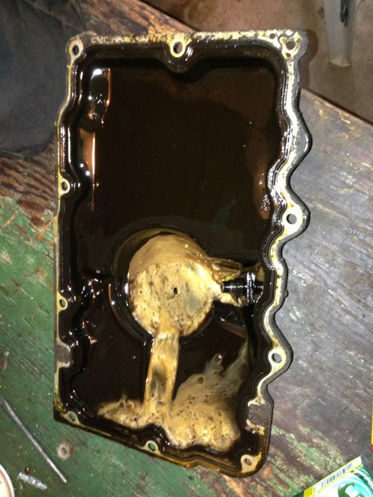

Found this while doing an oil pan gasket..
Alex98
Jul 4, 2013
23
1998
So i drained the oil and pulled the pan and found this..
Engine info: 2003 4.0L SOHC (38,XXX miles)
Anyway, I did an engine swap to my old 98 ranger 4.0 OHV to 4.0L SOHC I put 38,XXX miles on it, so this draws me to believe that it is a very slow coolant leak inside the engine. Head gasket maybe??
Yes it is and has me pretty worried. This isn't a common problem is it?
Assuming cooling system is still intact and sealed, no leaks.

That could also be from a bad PCV valve. Are you actually losing coolant?
Ok. 3 things that can cause that. Bad head gasket, bad PCV, and just sitting.
I found 3 inches of that crap in the oil pan of my OHV when I pulled it apart for re-build. Prior to my purchase of it it had sat in my foreman's garage without a valve cover for a two years, and then I kept it in my leaky garage for another year in the same state. If water gets in there and just sits in can cause that.
Yeah but it was definitely the color of coolant, while i was taking it off it started to leak out. I will take that into consideration and get another pcv. It was pretty much sealed when it sat. The cooling system wasn't sealed but everything else was. I'm going to put it together and check the head gaskets. I hope that is not the case here. I did valve cover gaskets while it was pulled and there was no milky sludge at the top of the motor. If it is the head gaskets the motor will have to be pulled again wont it??
PCV won't cause coolant in the oil, just snot.

Plus listen and feel for air flow out of the waterpump and where the intake coolent passages would be if the intake is off. If on? Then at the gooseneck where the upper rad hose connects.
S-
Thank you I'll get right on it, plus I'll throw a pcv valve in it. The motor has been sitting so I'm also gonna take into consideration it might just be water that somehow managed to get into the engine if all else fails.
Can you get the pick up screen off to give it a good look see ? If it is all gunked up ? Oil will pick up moisture from the air as condensation. Being heavier than oil, the water flows to the lowest point while the engine sits. Unless you drained a chocolate shake out before you pulled the pan, that was in a safe place away from stuff. When you do the compression test use Marvel Mystery Oil. Squirt it down the plug holes. If you have the engine out, check the freeze plugs and replace the rear and front main seals.
could it be the intake gasket?
