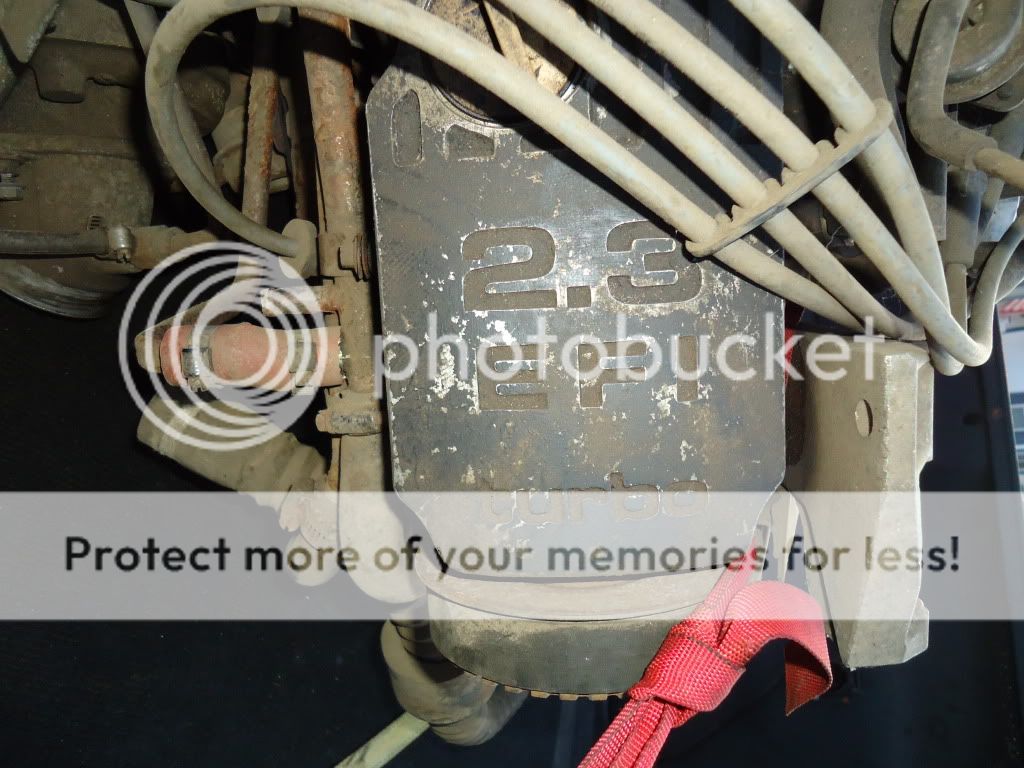

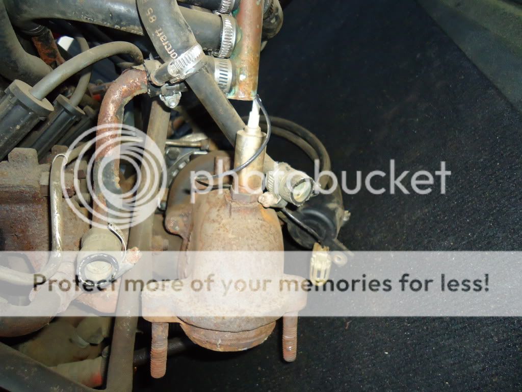

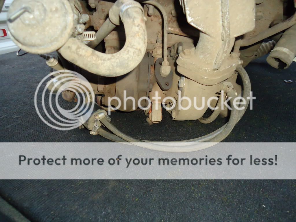

I just got back from buying it. It looks decent. I forgot coast=rust and some of the pulleys are rusty. I didn't check anything out other than sticking my fingers in the turbo and spinning it. I didn't check free play though. The guy seemed trustworthy but who knows. I will have pics up soon!
Here it is....
So, what do you think?

I just checked the turbo and its a Garret. It shows A.R. 60 on the front. And has a bunch of numbers on the tag. Also, it looks like its oil and water cooled! Sounds good so far.
not bad.
I wouldn't worry about any of the pullies as you can use everything that's mounted to your current engine.
Get a Ranger roller cam for it and put it in before you get to the swap. I gathered parts for at least 6 months before I swapped mine in I believe. If doing that swap intimidates you, I'll come over and help, there's a couple other things to do while you are that far into it too.

Pulleys aren't a big deal...but the internals are.
Do you have any suggestions for what I should do? I think running this engine would be better than running my current engine because of this engine is built for the turbo. Do you think I should run this turbo? I checked the compressor side and there was very minimal free play side to side (I was told there is supposed to be for the oil to flow around it) and there is absolutely no free play in and out. And it spins freely and there isn't any chips on the fins.
