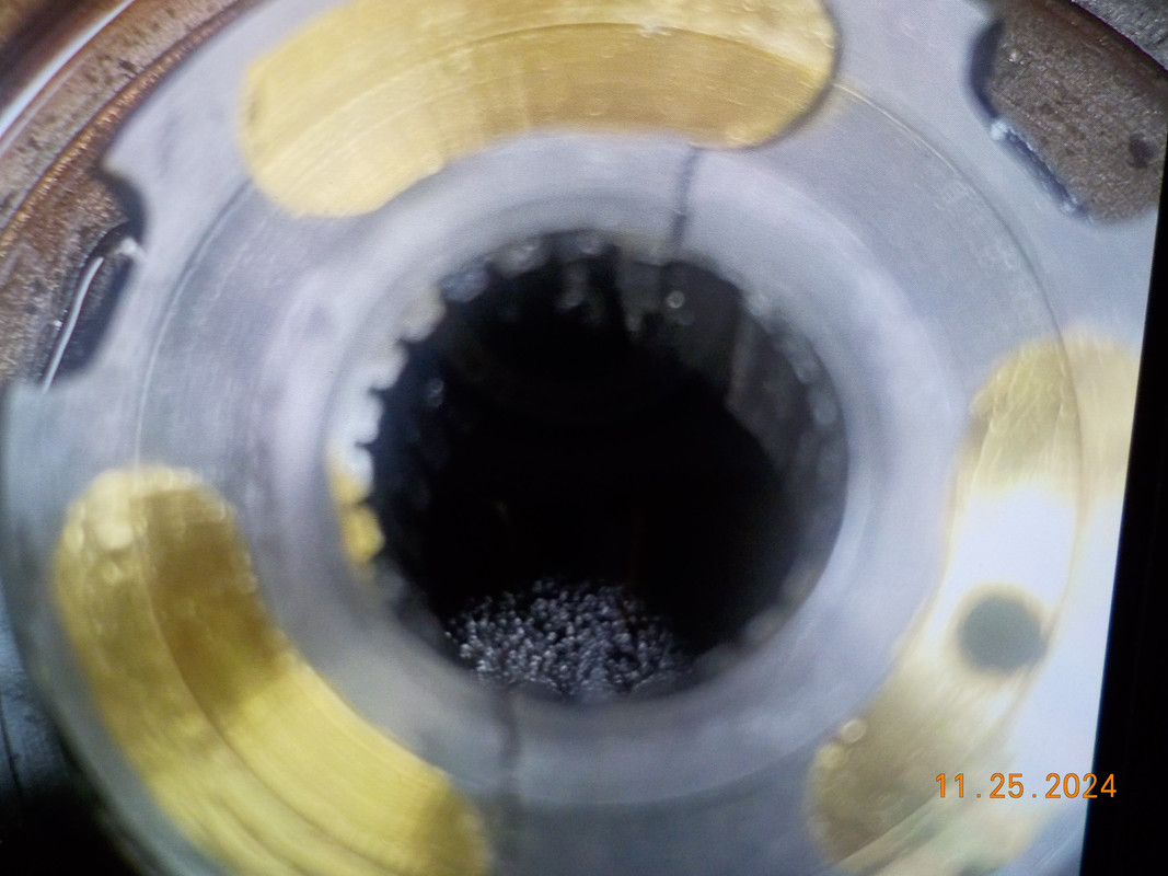

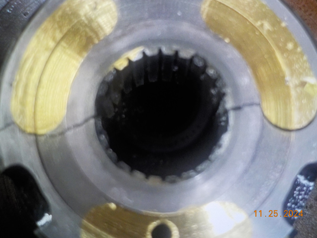

I got the transmission back today. pics of the forward drum failure:
I hope it got a complete overhaul, otherwise metal particles will tear it up quickly.
it was a complete rebuild although the clutches & other parts looked new.
Good, I wasn't concerned about wear because it was a sudden failure.
