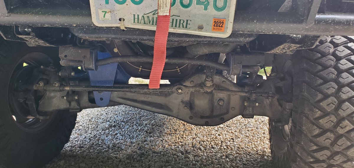

Problem is she flots at speed. It just doesnt feel glued to the road. Had it aligned at a good shop, but i am thinking that might still be the problem. Is it just height? Skinny and tall tires? Thoughts?
Here is my steering geometry

What type of joints on the shaft?
Do you have the spec sheet from the alignment? The geometry is solid.
Actual toe, caster, and camber... are the critical points if all of the joint and bushings are good.
