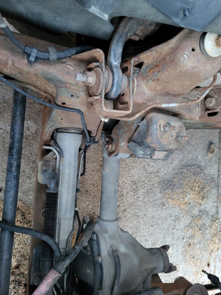

is that just the mount by the yolk, or all 3?
Just the mount by the yoke is missing
The other 2 mounts for the front axle are part of the engine mounts:
