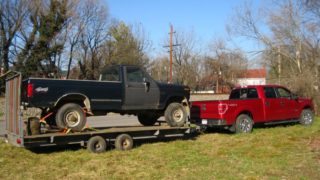

Went out and picked up a 1986 F-250 4x4 for 500. The guy told me it ran but was leaking oil, after looking it over I knew it was the right one. Got it loaded up on my buddies 17' trailer....had to use a come-along...that was fun only about 1/2 inch clearance on either side of the trailer. Well once I got back to the house we pulled a battery outa the boat and grabbed a gas can. put a little primer fuel in the 4bbl and crank crank varooom!!! started right up and idled nice! We let her warm up while pulling the straps off and then my buddy says yup its leakin oil. Well leak wasnt the right word, more like draining the entire system through what im assuming is a completely missing rear main seal! Well nonethe less we hurried up and backed it off the trailer, making it most of the way before it fell off the side of the trailer....very small clearances. and got it into the garage, almost going through the back wall due to the lack of brakes!! The e-brake kinda worked.
After a small amount of identification work I have assertained that I have a 351 mated up to a C6 with a NP208F transfer case. Dana 44HD TTB (maybe D50 not sure yet) front axle and Sterling 10.25 4.10 limited slip full floating rear. Which will all be going into the B2 and Ill make the money back on parting out the 250 and selling the old parts outa the bronc!

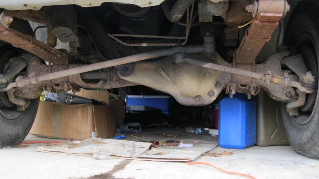

Sterling 10.25 MONSTER rear end :-D

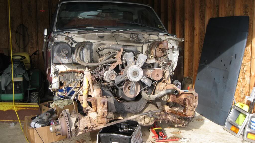

Front axle D44HD TTB
351W

Nice find, what's with the dipstick sticking out there in the open in one of the pictures though? That could be part of your oil leak problem is the lower half of the dipstick tube is missing completely.
I think that is a zip-tie.
HAHAHA I hadnt even seen that. I went out and looked under the truck and well unfortunatly its only a zip tie :-( But the oil leak is coming out of the bottom of the bell housing while the motor is running. Its a stream about as big as my pinky pouring out....pretty sad, ill fix it b4 i run it anymore lol....but it was still leaking when I shut it down so at least there is some oil left in it!!
Probably just needs a hub seal, and maybe a torque converter, if the stub is worn.
