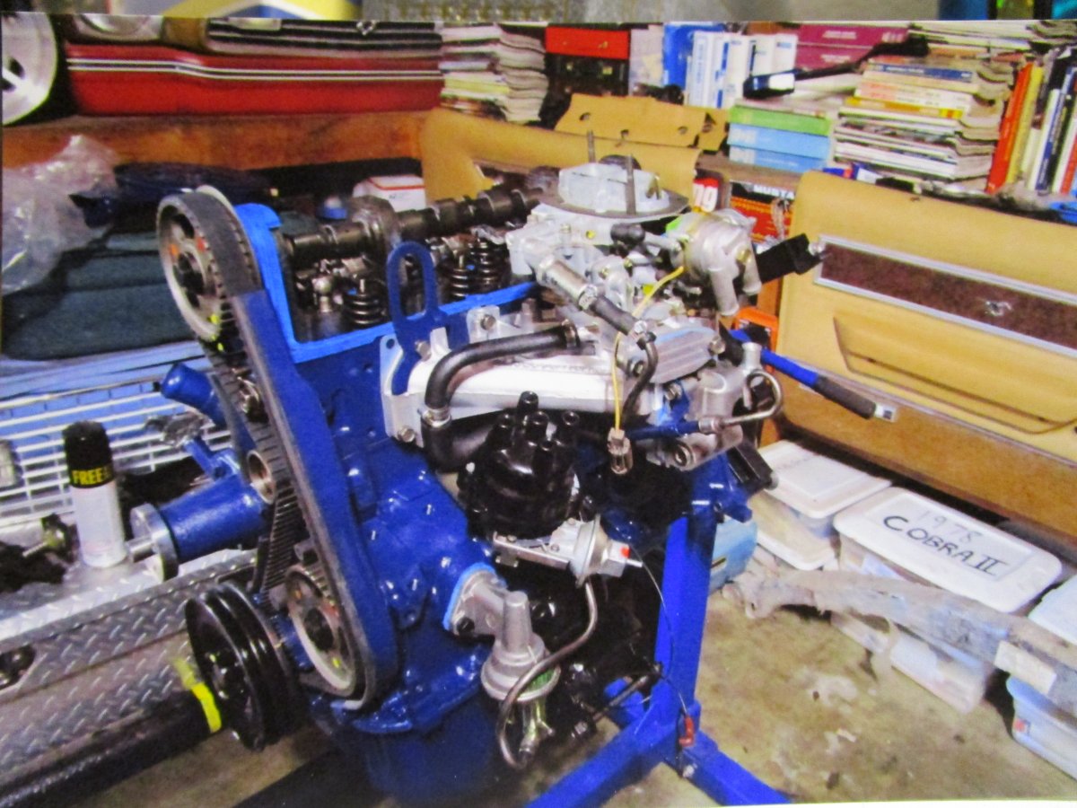

I would just install a Motorcraft 5200 off of a 70's 2.3L. They work well on my 2.3L Mustangs.
Ton's of 250 Granadas and Mavericks had non feedback YFA's, if you can find one. It seemed to me that the 2.3's with YFAs had more bottome end torque. I'm not sure if you'd need a different intake to run a 5200 or just a different spacer but I'll bet someone on here knows.
