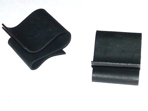

The bottom of the fan shroud is (4.0) flapping, . It appears to have tabs that tuck in the bottom of the radiator? Or i do I need some sort of bolts for sheet metal screws? Thank you?
There should be some little S clips that clip to the radiator and then those tabs sit in them.
Thank you!
be like?
yup. That's them.
Thank you gentleman, I've been to the hardware and other stores about four times in the past few days I keep forgetting about these as clips.
