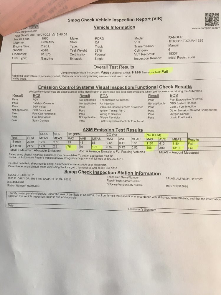

-Failed HC and NOx

-When I got home, I put a vacuum gauge on the EGR signal line and it was twitching a little as I drove it around but not enough to open the EGR Valve. I would assume It would need at least 5" of mercury to open, right? I thought KOER tested EGR/it's solenoid. No?
-I have a new O2 sensor and am going to throw it on hoping that addresses the HCs. At what point do I assume my Cat is bad and go get a new one?

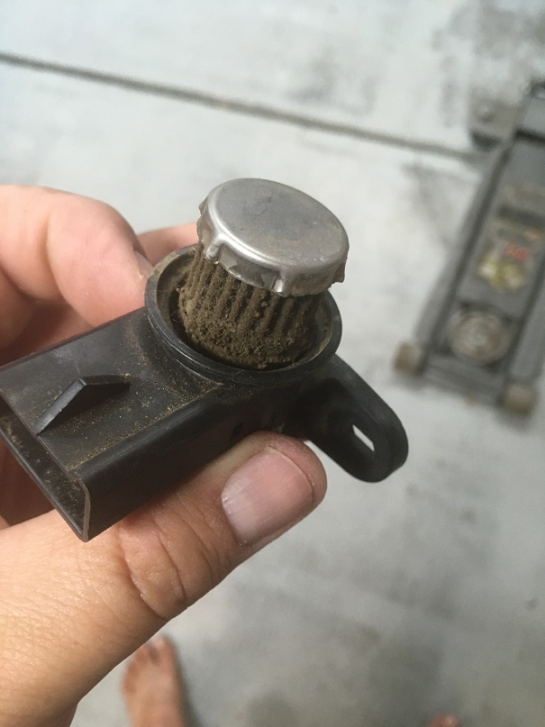

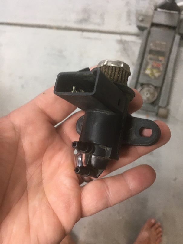

I only had about an hour to wrench today. Went straight to EGR control solenoid. Ran KOEO and got no codes. I let it go through all the cycles and blipped the throttle. My understanding is that puts the computer in Solenoid check test. My understanding is once the computer is in this test mode, each time I blip the throttle it is supposed to cycle the solenoids on then off.
I blipped the throttle a few times and the EGR control solenoid did not click so I pulled the connector. It has 12v across the 2 pins. It always has 12v across the two pins (unless I turn the ignition off). So I plugged the connector back in and put vacuum on the lower nipple; It would not hold vacuum. I put vacuum on the upper nipple; It also would not hold vacuum. I unhooked the connector and neither nipple held vacuum then either. That told me the EGR solenoid was dead (it did not switch whether it has 12v or not). Pulled it out and it's the original FoMoCo part. The filter on the top was nasty (yes, it had a cap over it and I took the cap off to inspect).

Took it home and it also does not hold vacuum on any nipple (either plugged in or not). Plugged in my connector and still no change. grrrr... Multimeter across the pins shows an open on my new solenoid. Old solenoid get 44ohms. I am also getting a code 83 now with KOEO. I guess I got a bad one right out of the box. I'll get it replaced tomorrow.
I am also bugged that I ALWAYS have 12v across that connector. Anyone got any thoughts on this?

OK, so after what RonD wrote, I went out and measured each wire to ground. I found the 12v source. And the other wire that goes to the computer. Resistance from that pin to ground was 4.2m ohms. Blip the throttle and it drops to 3.98m ohms.
With all 3 solenoids (exchanged the one I got last night) sitting on the bench, if I plug one nipple and apply vacuum to the other it does not hold vacuum. I hooked this 3rd one up to the connector and tried the blip test and I still don't get a click. Should I be checking my computer grounds?

Not sure there is any way to do a Static Test on EGR solenoid operation
Basically you test the solenoid's coil, 60 ohms, +/- 30 ohms is OK
Then blow thru either port, if you can't then valve is close, apply 9 to 12volts and blow again, if you can then valve opened
Working solenoid
If you wanted to run a vacuum hose from EGR solenoid and into the cab and put a gauge on it, then go driving you could see if computer is applying vacuum to the EGR valve
