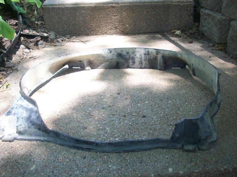

Putting a Explorer radiator in my '85 the shrouds were different. The clips that go thru the core on the bottom of the rad that the shroud sits in were farther apart on the 4.0 rad than the 2.8 rad.
Here is my "customized" 4.0 shroud, you can see how the tabs compare to yours.
It may be a year to year change rather than an engine to engine change too, I dunno but I had to get different shroud because of it.
