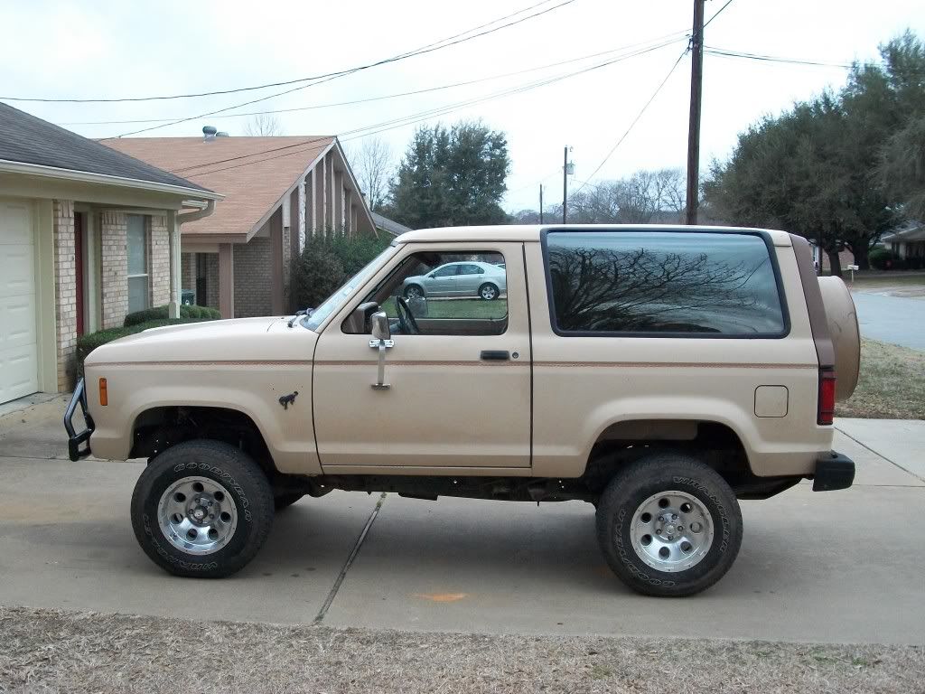

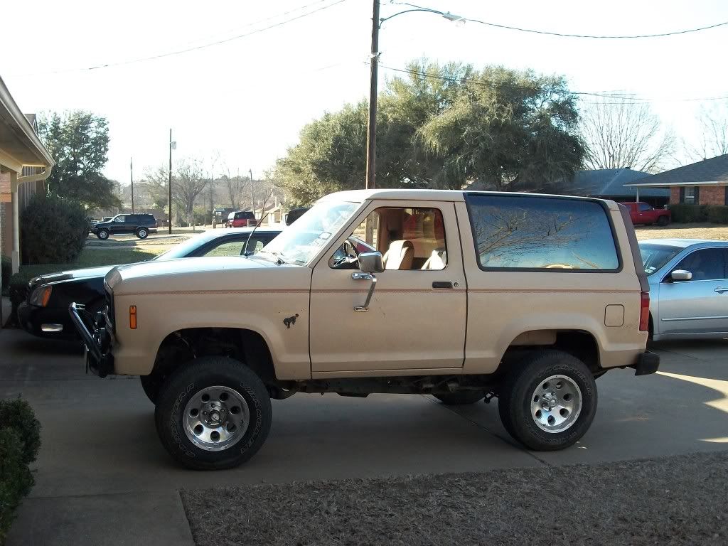

I got my leaves off a 95+. Now I wish I would have grabbed the rearend. I did get a small lift of about an inch or so. Also, contrary to the tech writeup I did NOT flip the pin on the leaves and it has been working fine for 2 months now.
Old springs
New Springs
The only downside I have seen is that the springs are stiffer, so the ride is a little rougher. This doesn't bother me since mine is just a toy and I only drive it about once a week.

Aight thanks guys, I'm off today so I'm about to go pick up a pair. Ill take pics comparing mine with the aal to the stock expo
Well I got them in and love em. I used 96 w code leaves, and kept the overload in. The front eyes were smaller them my b2, so I had to get some 9/16 bolts and its good. I gained about 1.5" over my worn b2's with aal. Ill post pics later, I'm on a road trip and my phone has been down
