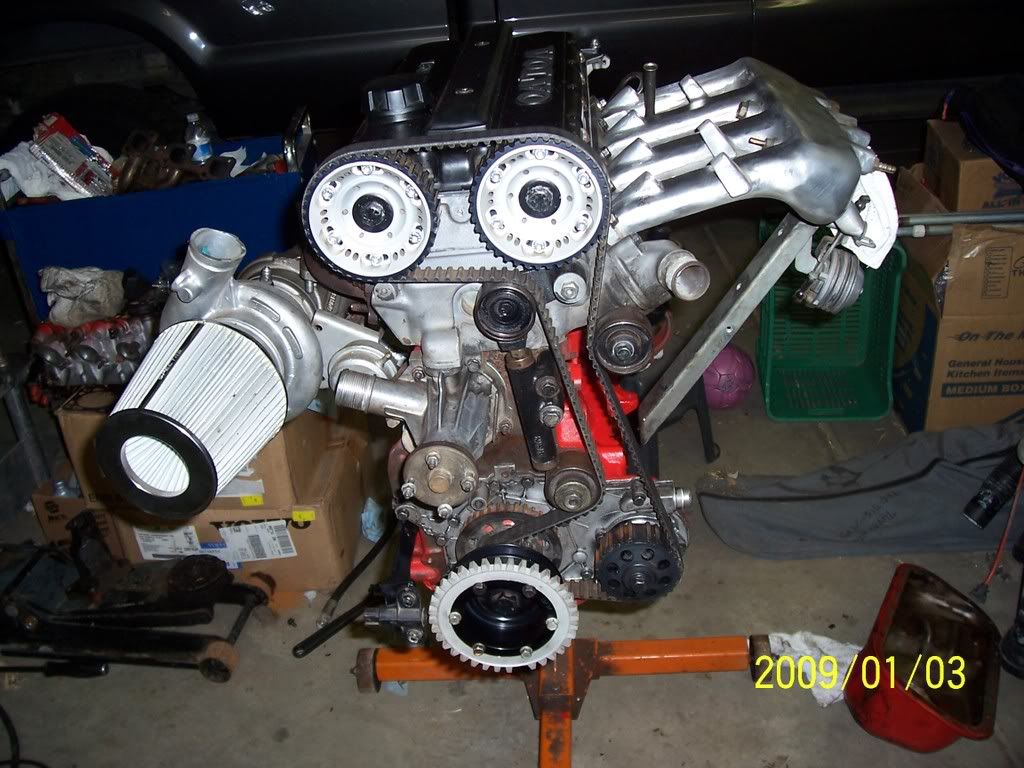

lol yup. I have several.
Notice my avatar?
its a 2.3 volvo.. with rods pistons and a few other goodies. before i put my header on.
I have lots of volvo info.. search turbobricks.com
its for my 83' 242 volvo..jvab internals, megasquirt, coilovers, 5 linked, prp bucket seats, 1000cc injectors, 4'' intercooler, ttr cam gears, underdrive pulley, edis, ipd sways, 13'' brembos, tko600, rollin on 18" Atlantis, flathood, vdo gauges and more..Im actually running a ford trans.. i bought a brand new tko600 for it..
