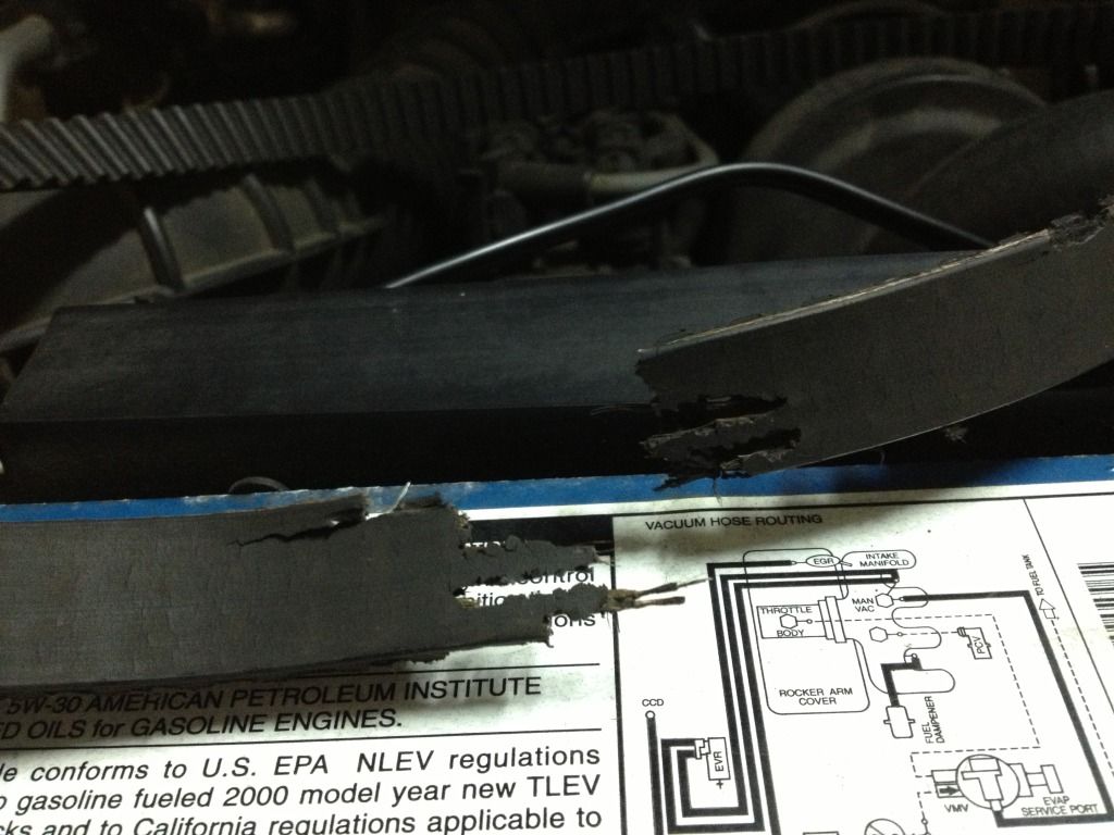

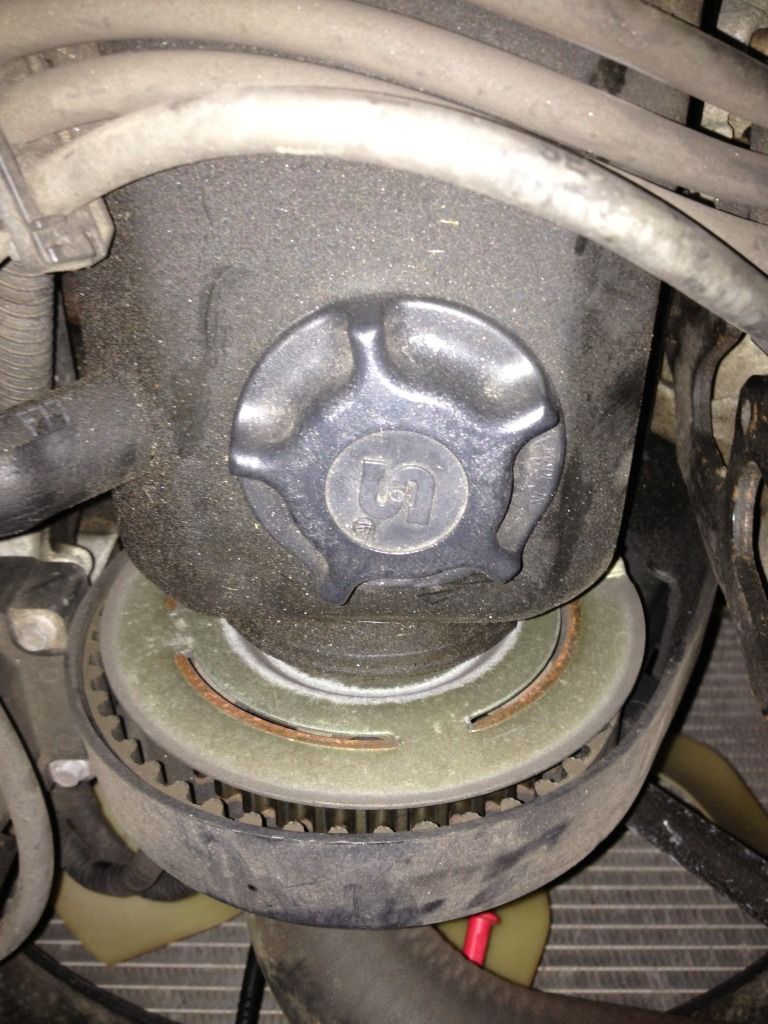

I think i found my timing belt...
Sorry it's upside down. :p
Then I pulled it out to find this:
So now that my timing is f-ed, what sort of problems could that have caused? Pistons hitting valves and such? How easy is setting timing? I'll read manual tonight
