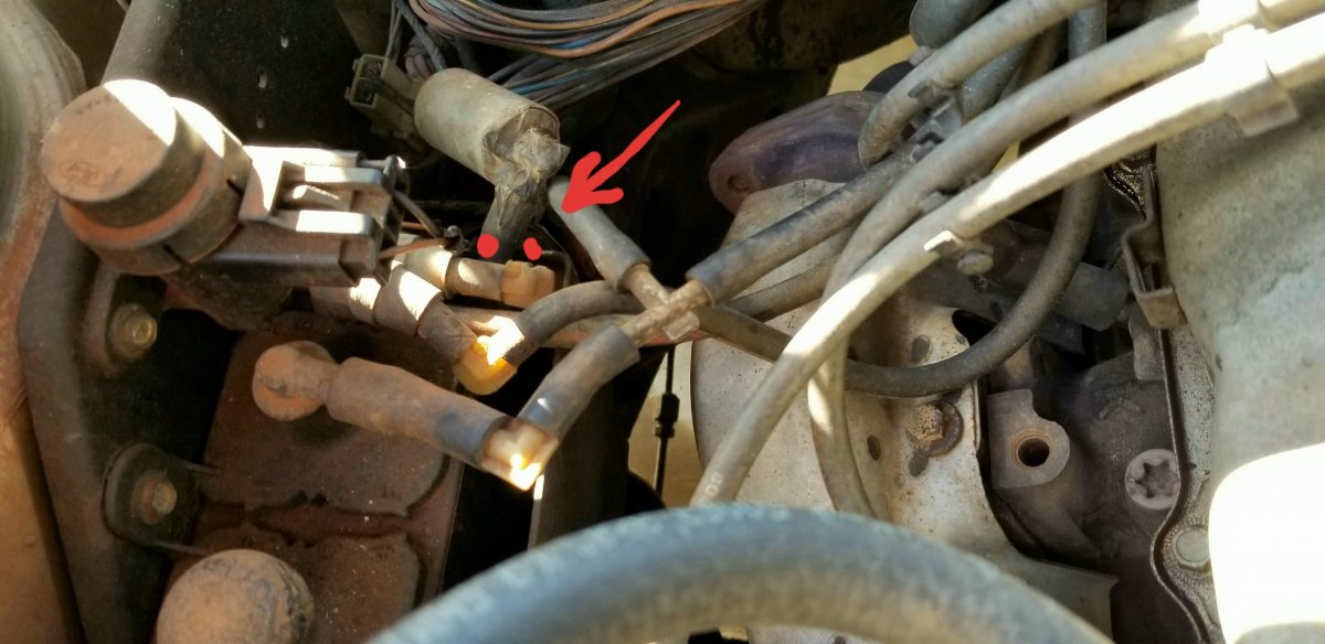

Disconnected hose - A small hose has been disconnected for over a decade
Link to photo: https://photos.app.goo.gl/x1DPfvSmJydmdhmU9
