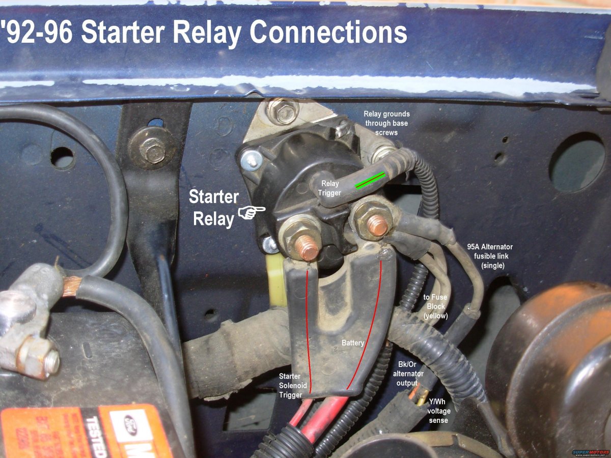

Usually on driver side inner fender. Might look sorta like this.

Also in the picture the green tag is on the wire from ignition switch, its a push on/pull off connector, try pulling it off and see if starter stops spinning, if so that would mean problem at the ignition switch

If you look at the picture ericbphoto posted, #4 post, of the fender mounted relay
There is the larger red cable from Battery positive connected to one larger post, and it has several other wires connected on same post, that's the 12v power distribution post
The other larger post has the smaller red wire, just by itself, that wire runs down to the "S" post on the starter motor's relay
The wire with the green mark is connected to the fender mounted relay's "S" post, that wire comes from the ignition switch and has 12v when key is turned to START
When key is turn to START the fender mounted relay closes and the smaller red wire gets 12v
Then the "S" post on starter motor gets 12v and starter motor activates
You can either extend the wire with green mark so it can reach the "S" post on starter motor, by-passing the fender mounted relay
Or you could splice the green mark wire and small red wire together, by-passing(jump) the fender mounted relay
Either way the fender mounted relay would no longer "click"/activate because its "S" post is open, so its no longer needed as a relay but the one post is still needed for power distribution
