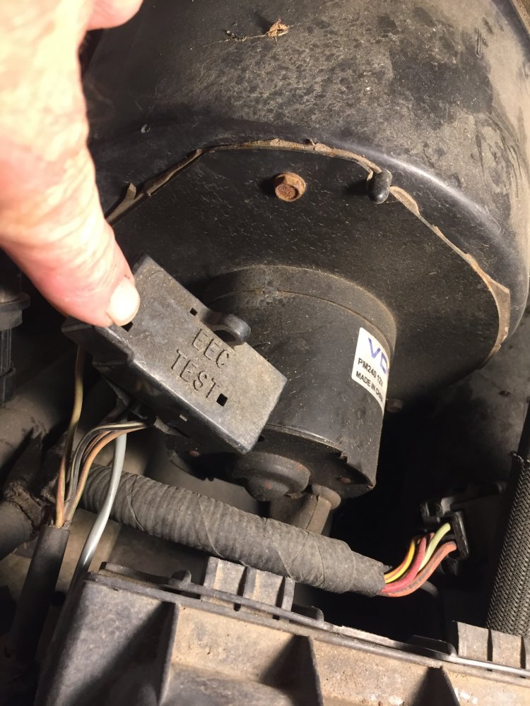

I can't find it anywhere, even took my air box out to see if it had gotten under there. The only thing I could find was a short wire with a black connector on it that had a gray plug in it (2 pins). I followed the wires from pass. side firewall over to the driver side and can find nothing that even remotely resembles the diagram.
It will be in the engine compartment passenger side close to heater blower motor. Red I think

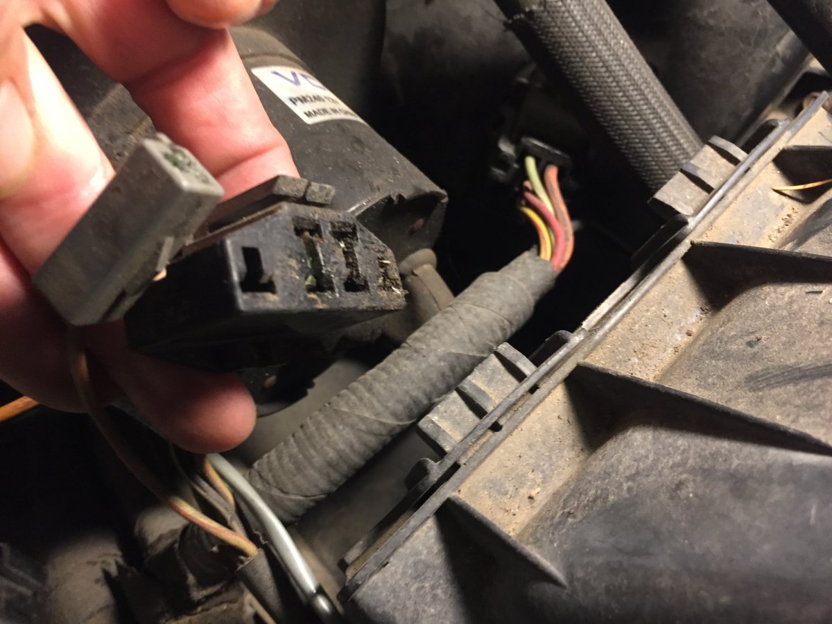

Sorry. Wasn’t red. It has a cap on it

Now we're getting somewhere, I did see a small box mounted to the end of the power dist. box with EEC on it I pulled it off and saw, I think, 4 separate plugs in the bottom of it but I didn't take the cap off. A picture is truly worth a thousand words. Thanx man, that helped immensely. You and your pictures can intrude ANYTIME!!!!!!!!!!
it’s a simple test plug and will allow you to hot wire the pump but I believe your issue is elsewhere. You mentioned your ignition switch was unplugged and you thought you hit the sweet spot. That’s where I would go first. If it’s not on squarely only some things will work. Said from experience. Stay tuned. Standing by. 😁
